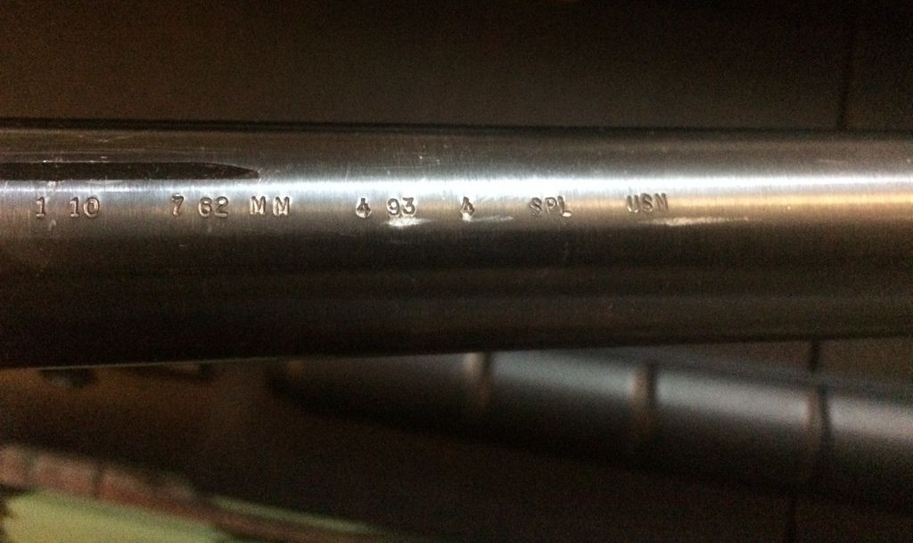

Who was the barrel manufacturer?
(see pic in post 73)With all the interest in the XM25 i'm reintroducing this post in the hopes that someone can shed light on this question,someone has had to of seen them,someone had to of marked them,but the question is what did they actually stamp on them
