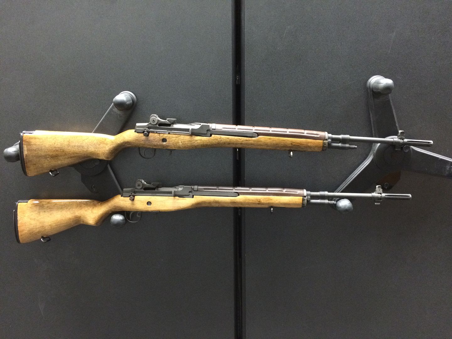

Reason I ask is it seems that a usgi FH that I saw recently was darker in color than my grayer, 350,000 serial number m1a standard. I would like to drop this thing into a usgi stock, usgi FH, and refinish it to match a GI M14. Maybe even add a faux selector.
So would the usgi guns actually be darker thab my grayish m1a or is the FH reference just anecdotal?

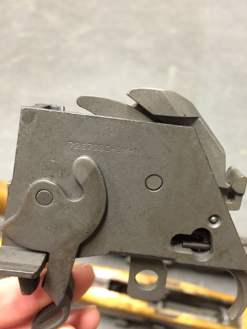

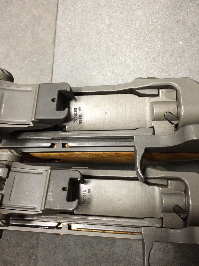

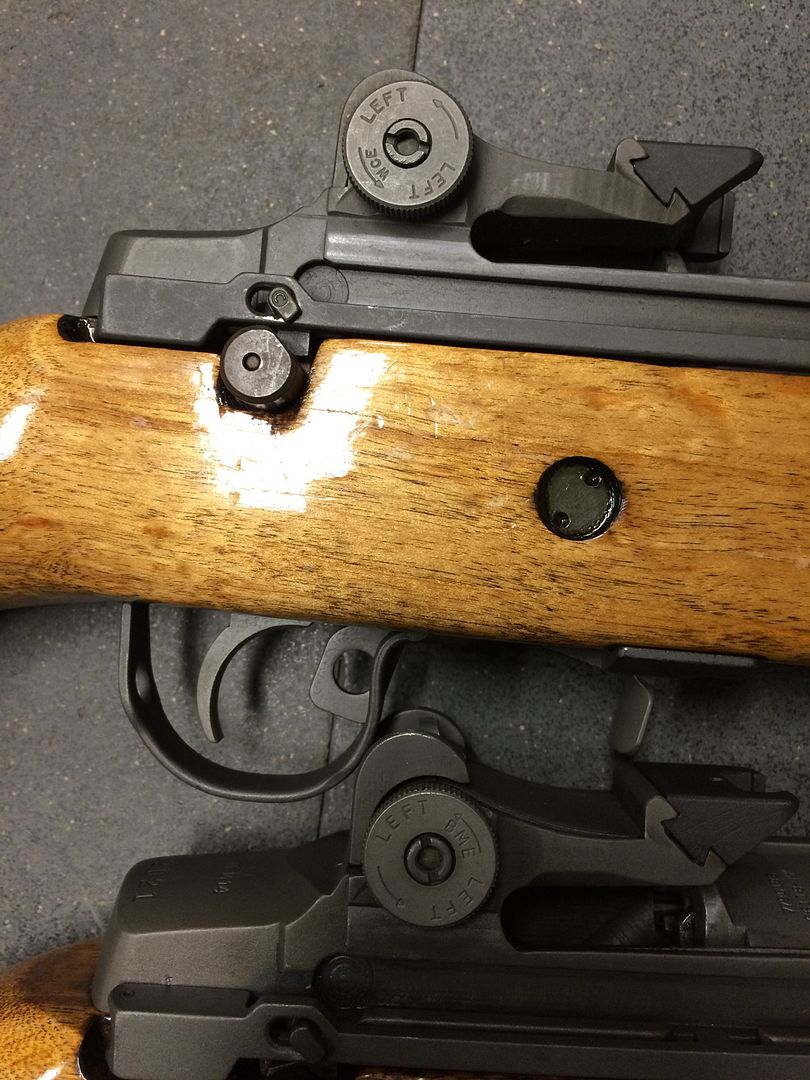

Looking at the pics the bolts are marked "kk" & "ww"
The windage knobs are "wce" & "bme"
And the trigger is "cm-n"
All markings are new to me. Different from the traditional usgi markings.. I was under the impression that no new m14's were being produced other than Smith enterprise..
Can someone explain these conflicting marks..and as the poster said "real m14's" I assume they are of the same grade or better than usgi..why I never heard of these particular marked parts on this forum? And why are these not sought after for home builds or replacement parts as the usgi ones?
4,078 Posts
Kk,ww;are the heat treatment code, or lot number. The windage knobs are reai deal USGI windage knobs. The trigger housing is marked, OM-N, this is for Olie Mathesson, for Winchester., These are all USGI Parts and are sought after.
Someone can correct my spelling.
290 Posts
Both bolts were made by Winchester, as indicated by the 66118 manufacturer number.
WCE was a subcontractor - Wilco Electric Co
BME was a subcontractor - Bruce Machine and Engineering
As noted above OM indicated Olin-Mathieson Chemical Corp, which is the parent company to Winchester.

I didn't realize we were discussing the pictures I posted months ago. RNGR3
75nova, if you've never seen those, check out my thread here: http://m14forum.com/reference/180945-winchester-olin-mathieson-parts.html
A few photos down you'll see manufacturers such as Han-dee Spring, Stanley-Humason, Hesse-Machine, etc. all making parts for Winchester. Thought you might find it interesting. RNGR1
