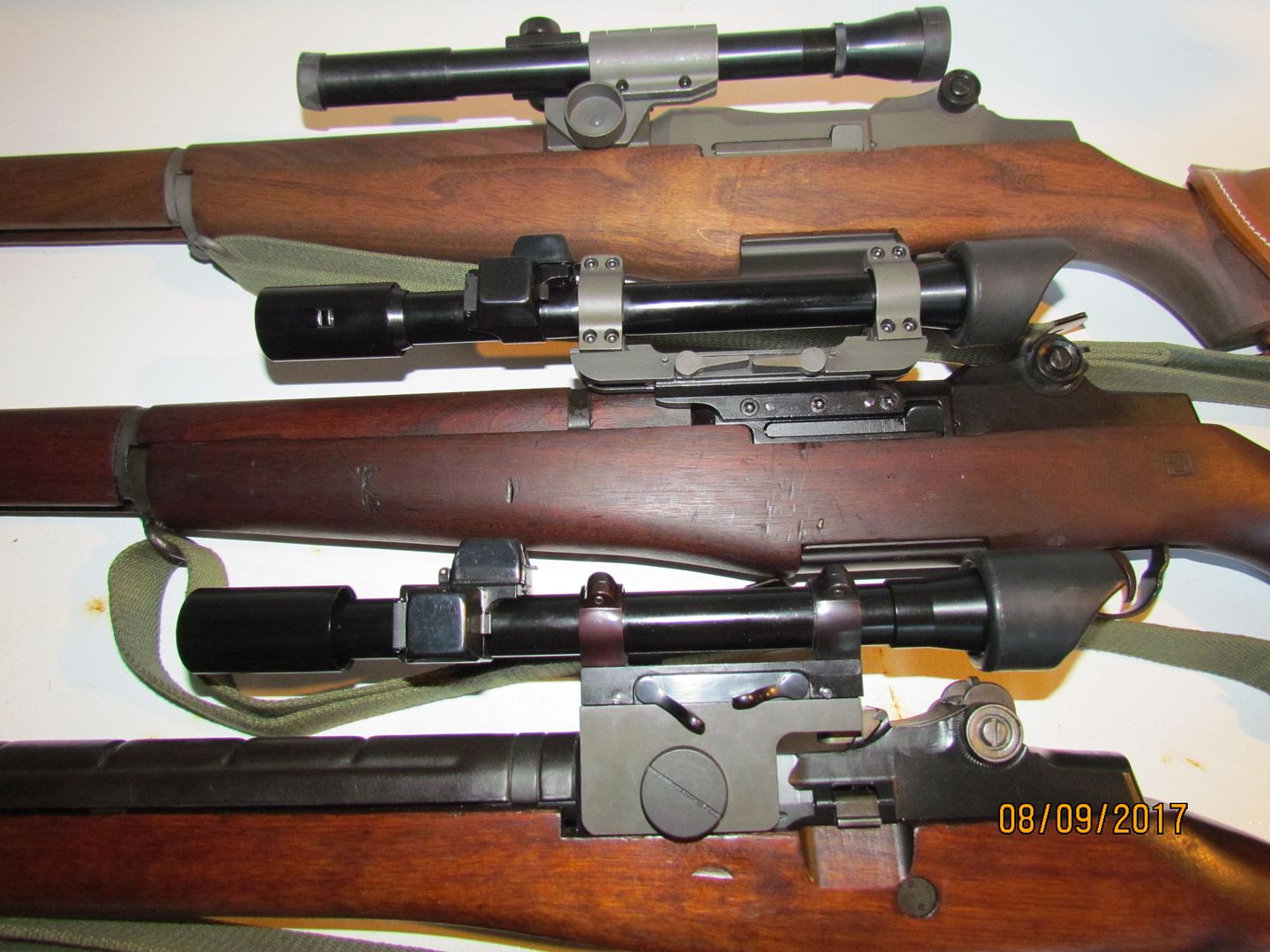

The article was decent in that it discussed the original M1C and M1D, from late WWII and Korean war era, but unfortunately it left out the later version of the M1C used by the USMC, called the "MC1952" model with 4X Kollmorgen MC-1 scope, and it left out the mid-1960s M1Ds that used a 1" mount and 4x Weaver scope. Those two later models are shown at the top and 3rd from the top in this picture:
444969
Reactions: 5

M1d on top then M1C with MC-1 usmc mount then M14 with M1C mount. Scopes and mounts are interchangeable between M1C and M14.
