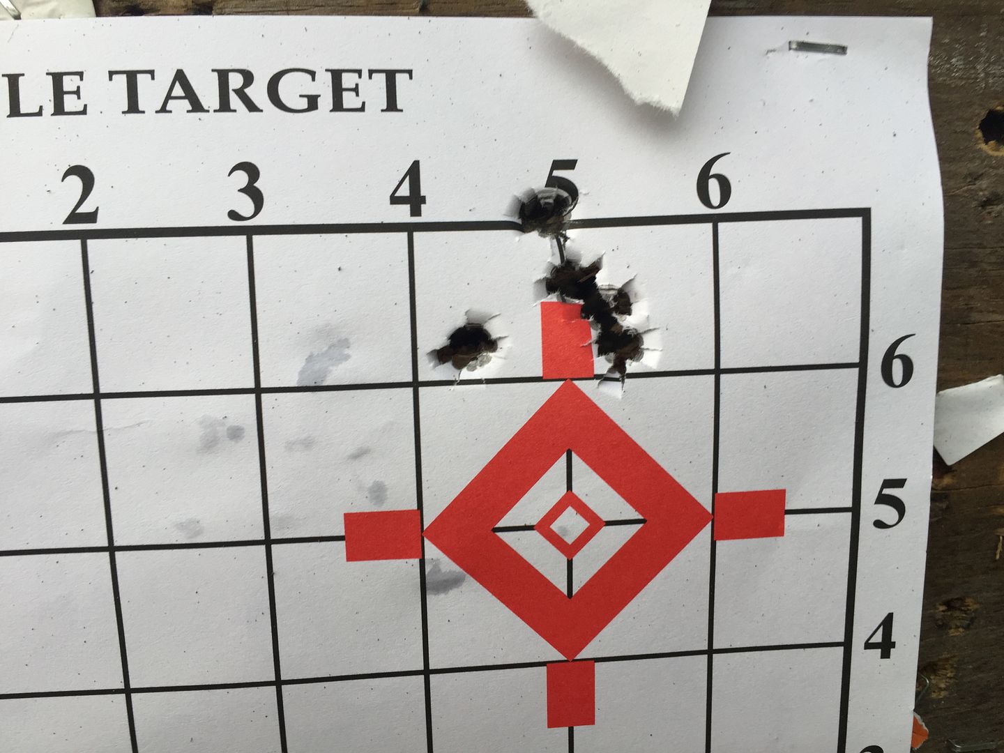

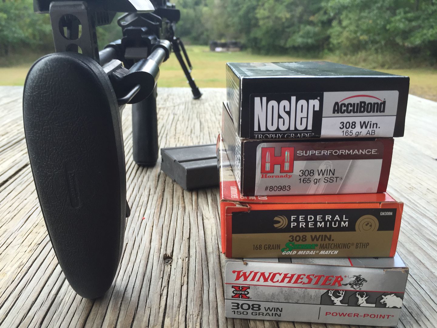

decided to test some ammo for a hunting trip this spring.
I was pretty wound up from work so i dry fired for a half hour to calm down at the range. nice 80 degree weather and the range was mine to myself.
having trouble getting some of the pics uploaded but here is my best group with the nosler rounds. all groups are 5 shot at 100yrds.
5 shots of federal GMM

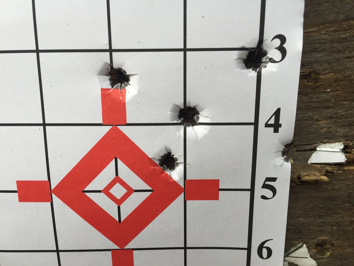

well my computer is dumb and i cant get the other two up. basically the winchester shot like the nosler rounds but low and the hornady rounds were terrible for me they really opened up.
all shots were made from the Mistress (SAI scout in a sage)

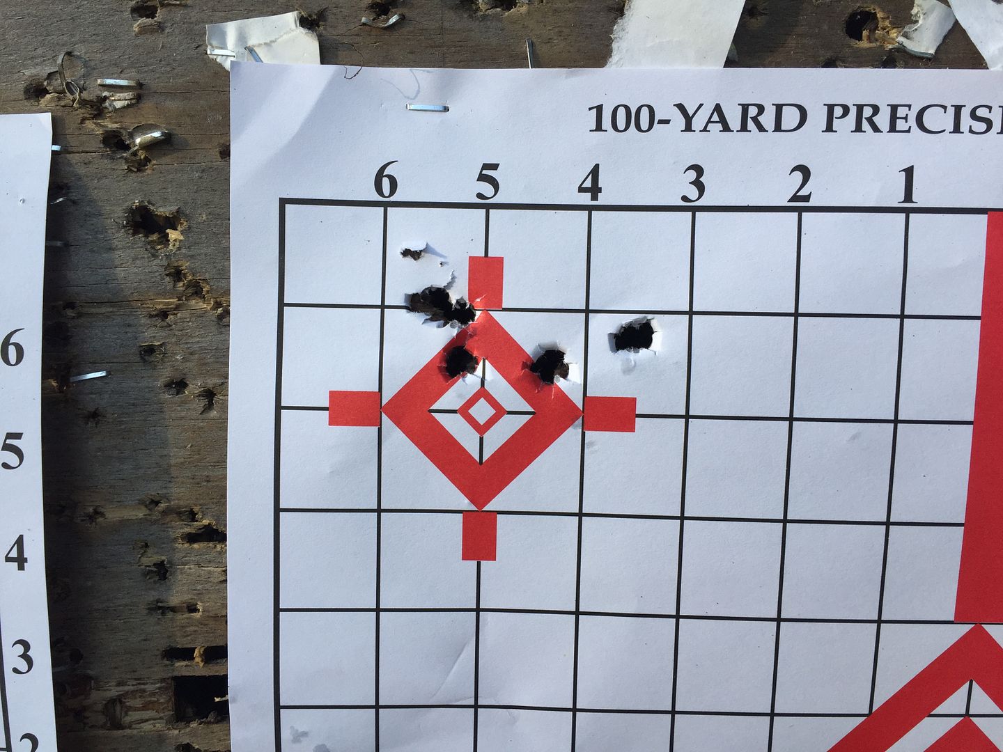

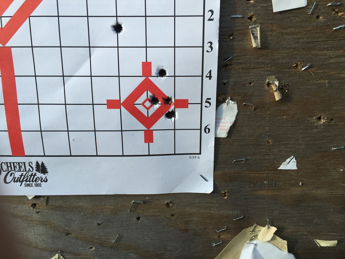

Went out and tried one more type of manufactured hunting ammo. after thinking about what Kurt said about muzzle velocity i started looking at the boxes that i tested and all of them stated they have a muzzle velocity of 2820fps. so i did some research and found Federal Fusion 165gr with a muzzle velocity of 2700fps. So i shot a box of it this evening to see what it can do.
[/URL][/IMG]
i first noticed that they used the same brass as they use with FGMM for the Fusion bullets. here are the best two 5rnd groups shot at 100yrds with my SAI scout in a sage. ignore my one shot that i pulled :(
Overall i think these bullets did exceptional better than Nosler, harnday sst, and winchester sp. Plus there a lot cheaper. i was going to try some remington core-lokt but they advertised muzzle velocity at 2820fps as well. (this must be a new standard muzzle velocity for hunting rounds? 2820fps). i will save the the left over ammo for my old man to test in his gun when he is ready. We are currently looking for a scope for his DPMS 308. so no shooting for him until he decides.
