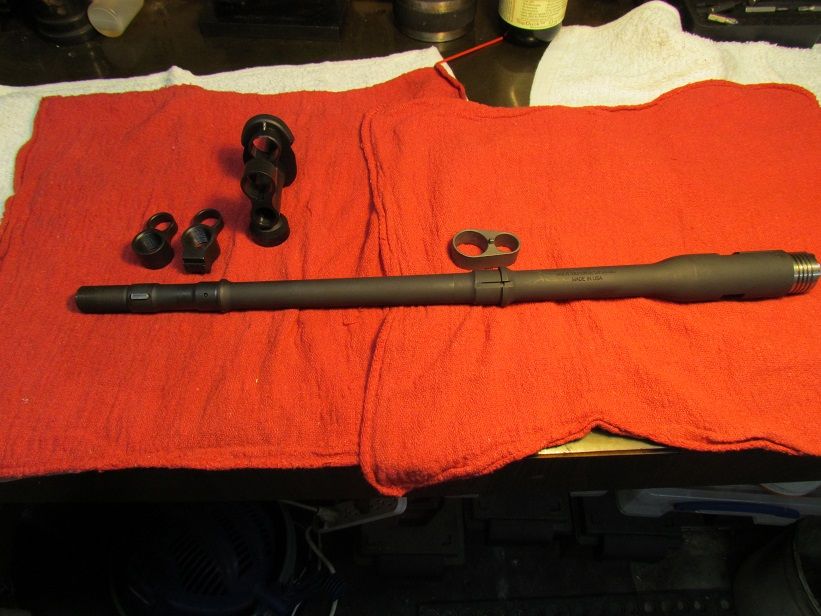

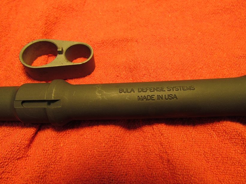

Brand new design barrel manufactured by Bula Defense Systems.

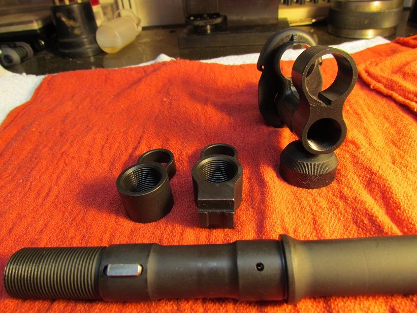

This is a suppressor ready M14 type 16" barrel. Muzzle is threaded 5/8 x 24 as is the new gas lock. There are two types of gas locks in the photo, one with a front sight dovetail base and the other with no base for use with optic set ups only. Gas cylinder is keyed rather than the old spline. Op rod guide is also keyed. These will be available on rifles built by Bula soon.

Bare of coarse. They haven't done chrome in some time. I like the ability to ream to my desired headspace rather than changing bolts to an end product.
Had some fun in the shop this afternoon. When someone says the parts are mean to be press fit on one of these, they really mean it. This is a semi-permanent assembly. Not a conventional M14 build, that's for sure. This " unit " is ready to be indexed to a receiver tomorrow.

Excellent Art! I'm sure you'll have it together in no time. Can't wait to see the rifle. I see you have a unitized GC. Very cool!! I was shooting surplus ammo with those results.

I have modified gas plugs on the way. Thanks for the heads up.
