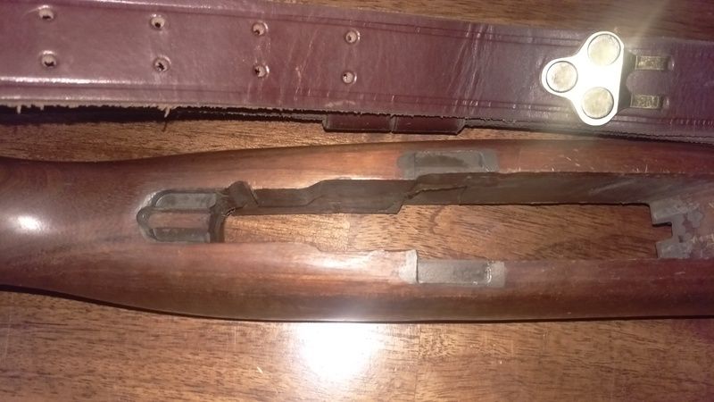

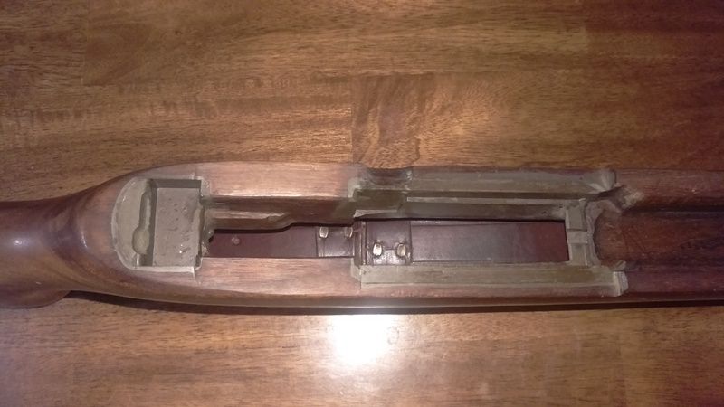

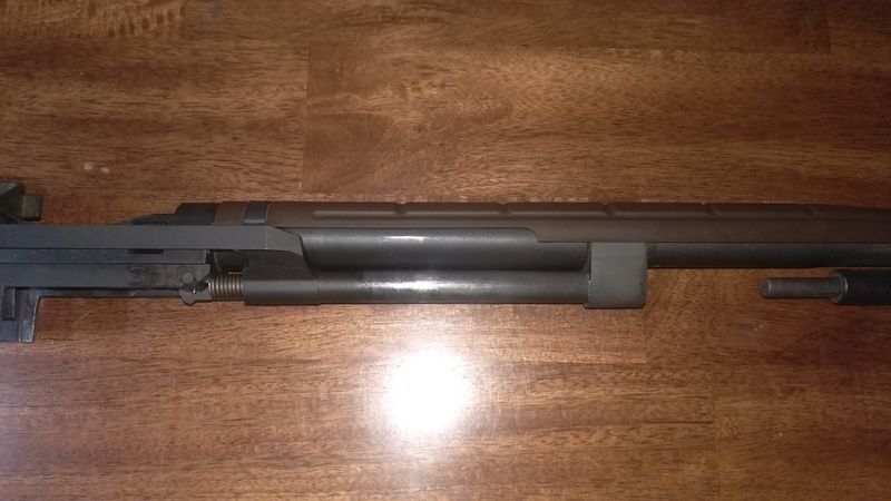

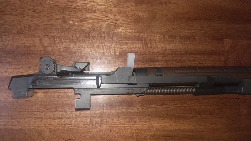

I was able to go and have a limited inspection the rifles and take some pictures. The seller claims that neither rifle have been fired and that he is the original owner of both.
He was very reluctant to allow me to take the trigger group out and inspect, I was not allowed to take the action out of the stock.
It appears that both rifles have SA GI parts other than the TRW bolts. The SM is bolted into the stock at the front and rear of the receiver. Only identification I could see on the limited view of the barrels was a mark of 3 interlocked circles on the SM barrel. (see picture)
My personal opinion is that both rifles have been fired. And I do not think that the SM left SA in it's current configuration.
Here are some pictures. Let me know what you think.

When if ever, did an SM use a heavy stock with a stock liner? Also, Super Match M1A is a trademarked name by SAI. So, if it wasn't built that way by SAI, it's not a Super Match.
I'd say buyer beware. Might be a nice match prepped rifle, but it isn't an SAI built Super Match. Even if converted, they would have a record of it.
This is my SM:
Original bedding, no markings on the heavy Douglas barrel, no stock liner in the heavy wood stock, rear lugged (not welded). SAI confirmed it is a Glen Nelson built SM. Serial # range 0876XX built 2/95
