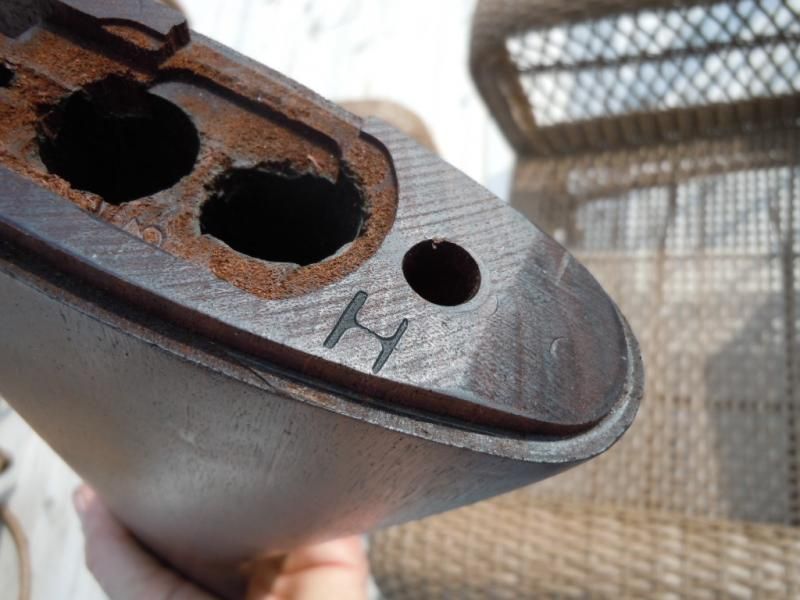

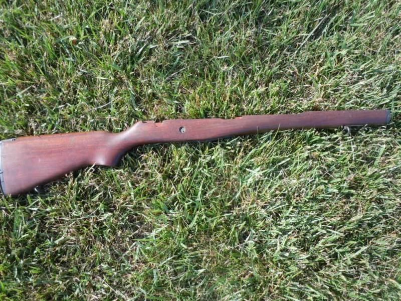

I don't have a camera to speak of just yet, but if you have photos to share that would make for a nice thread. I have a H&R USGI stock (It walnut). I know because of the "H" under the aluminium buttplate, at least I think any way.
My stock has a strait forend one it that does not have the same look like others I have seen. (Different manufacturers?) I was looking for the other look, and it seems they have subtle differences.

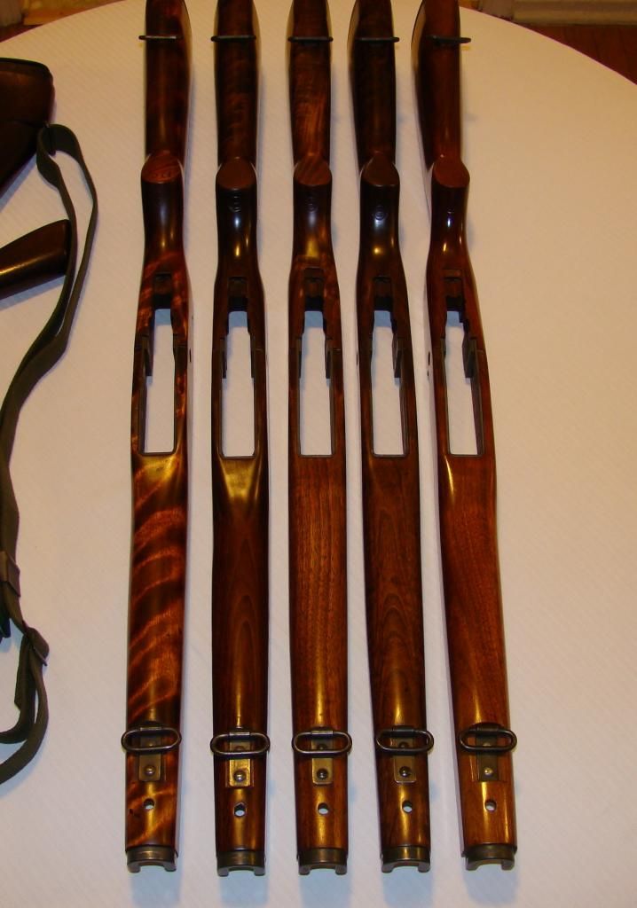

Well this is right up my alley. It will take me a while to take individual pictures of the stocks I have but I can get this done in a few hours.
First, I like them all, though I am partial to my S.A. M14E2/A1 stocks as they are extremely rare and in "P" grade condition. The other stocks are all "P" grade except the Overton Tiger stripped birch and it is in excellent condition. All have been cleaned and very lightly sanded using 600 grit or higher, no staining was done, just Teak Oil added for that hand rubbed finish.
If you will look closely you will notice that they all tapper towards the front ferrule with the Winchester having a little less tapper and just a little thicker in that area. The Overton stocks(made for TRW) are a thicker stock through the forearm and the wrist area.
The Winchester is the only stock in this collection that has the gorilla thumb nail at the front ferrule, the rest are pin punched.

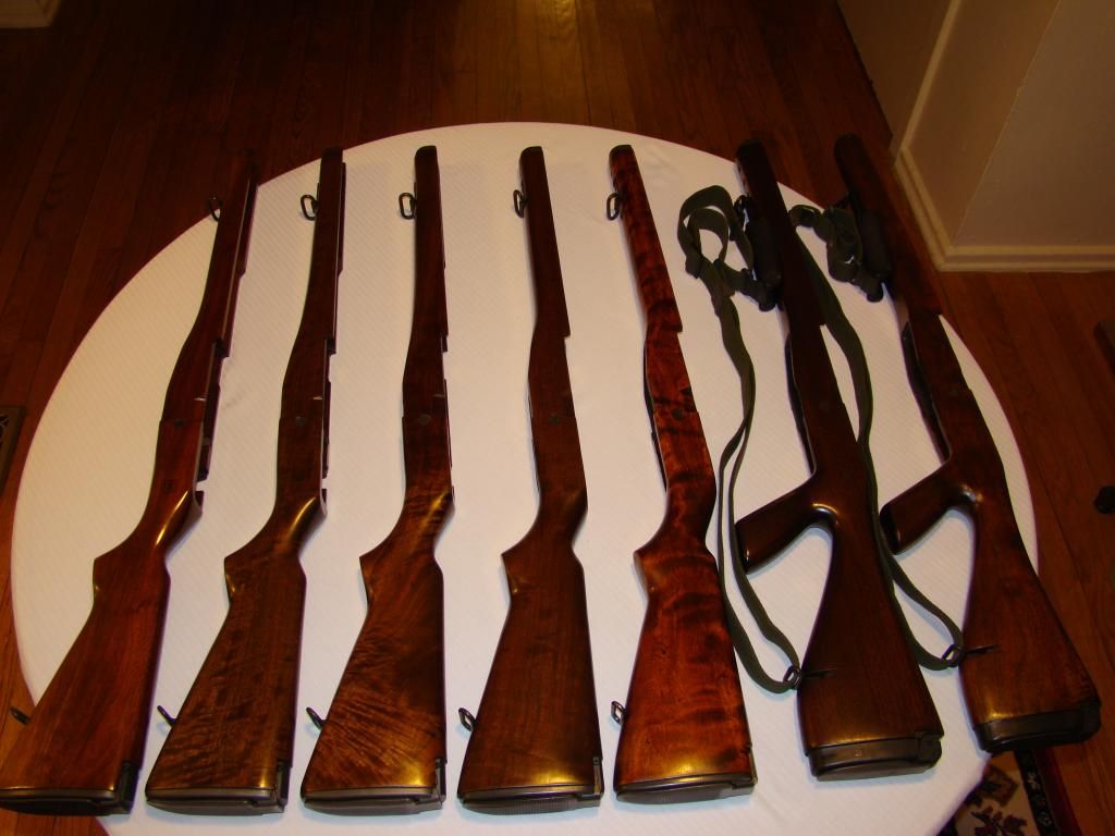

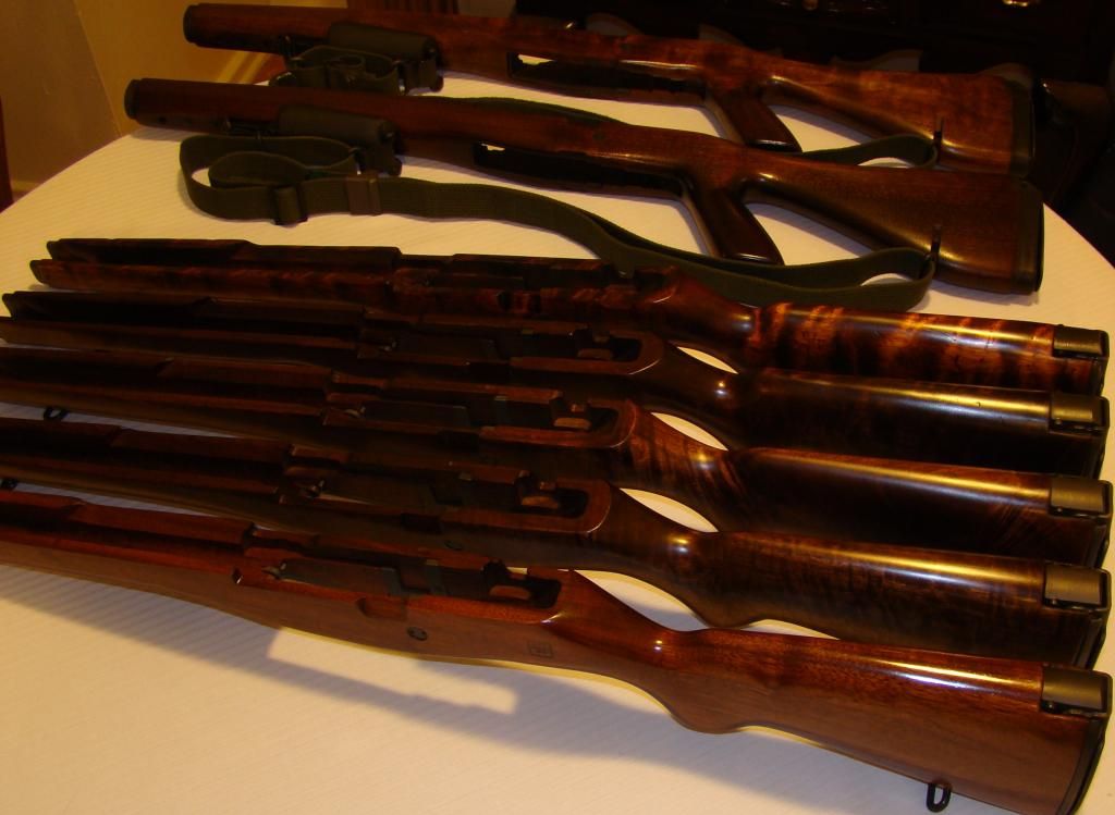

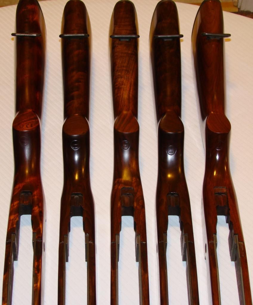

This is going to be picture heavy, I will try to point out differences in the stocks that I have.

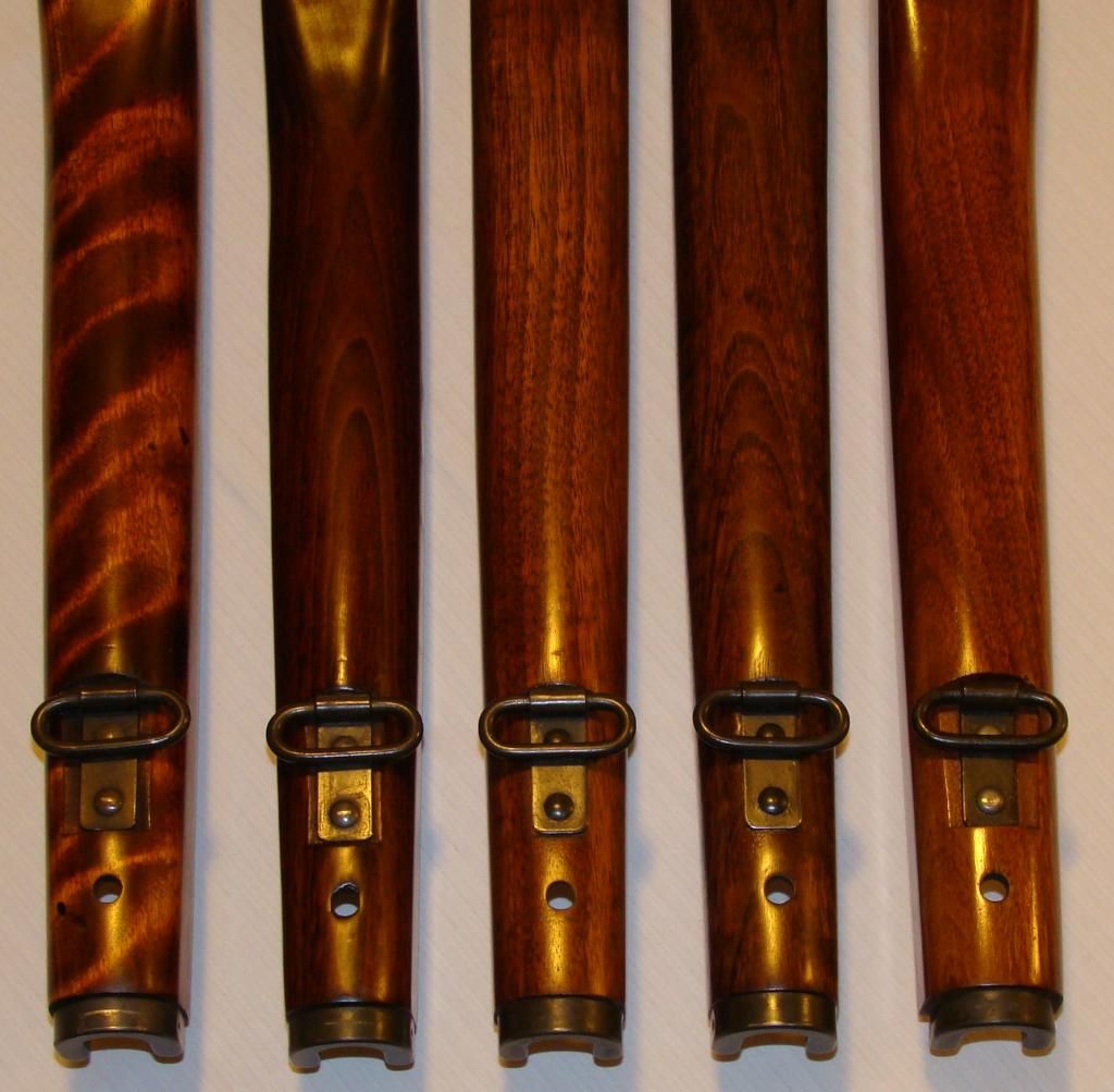

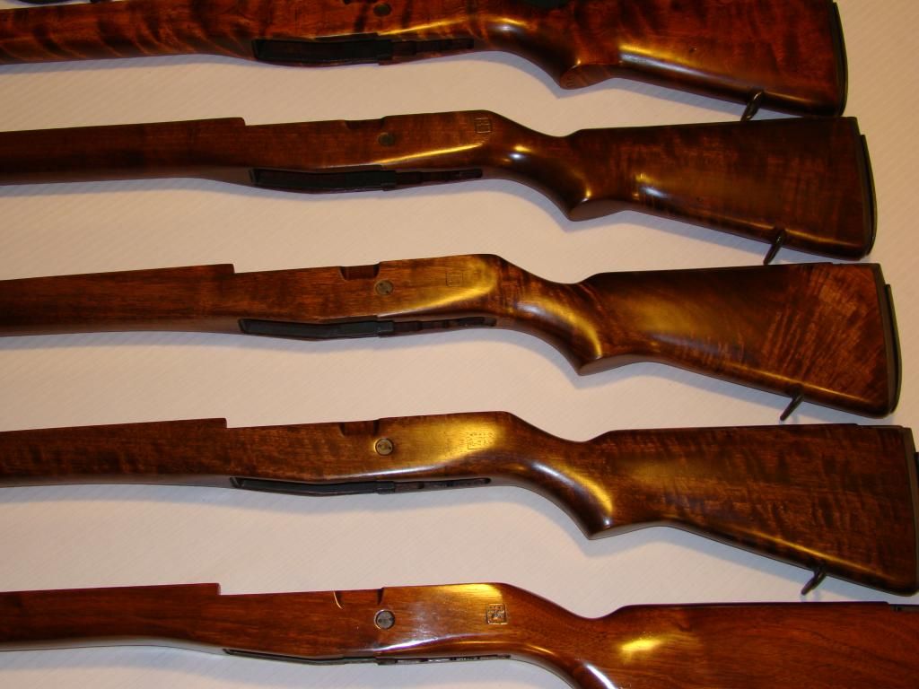

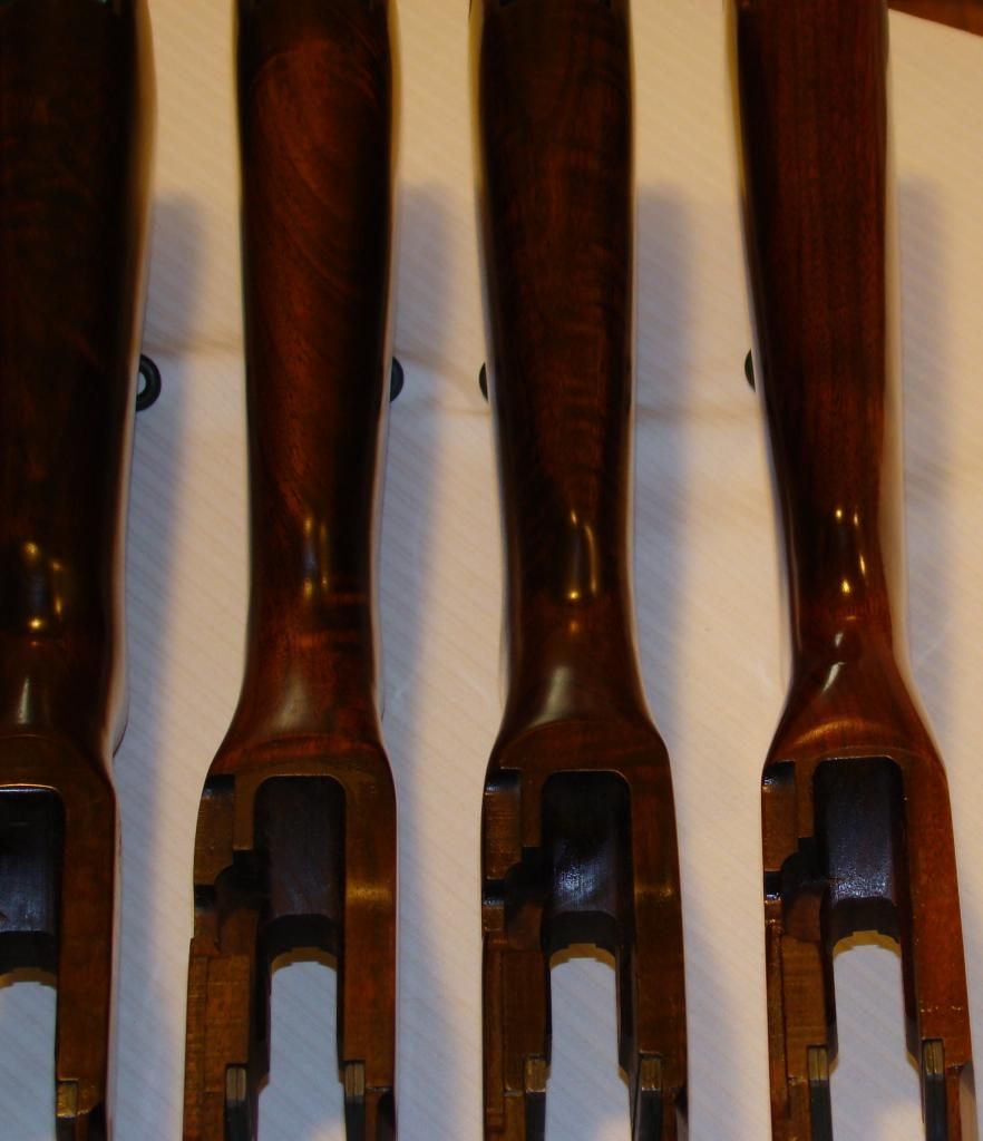

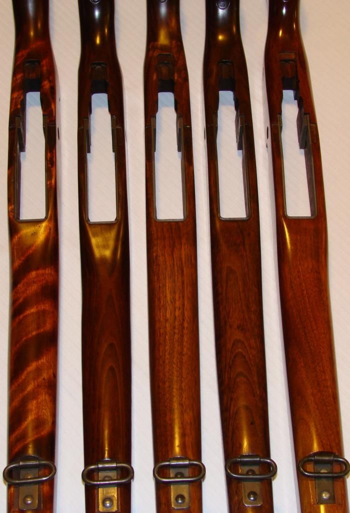

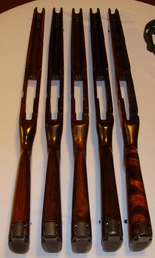

In the first picture are from left to right Winchester,Springfield A.,Springfield A.,Overton,Overton, both E2s are S.A.s

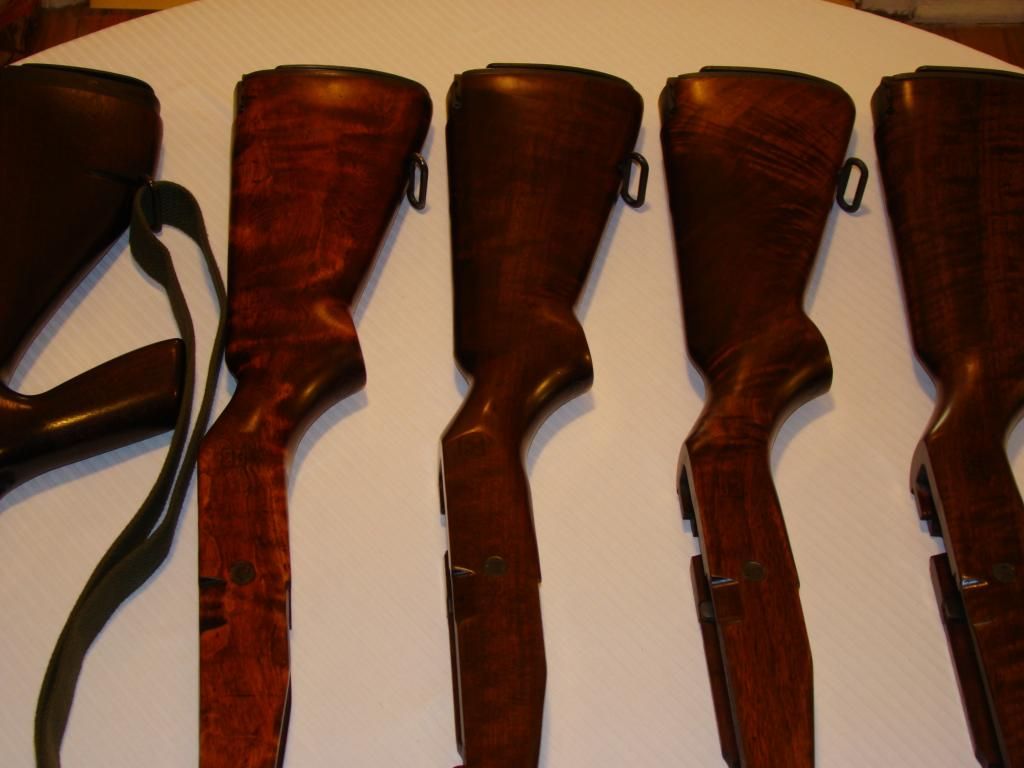

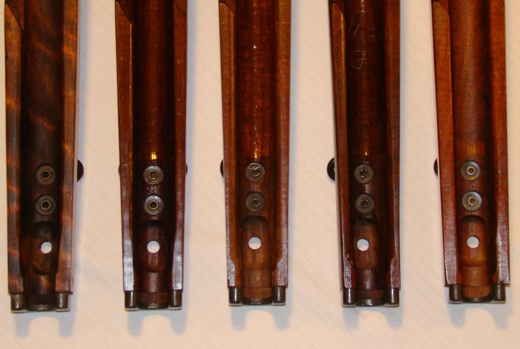

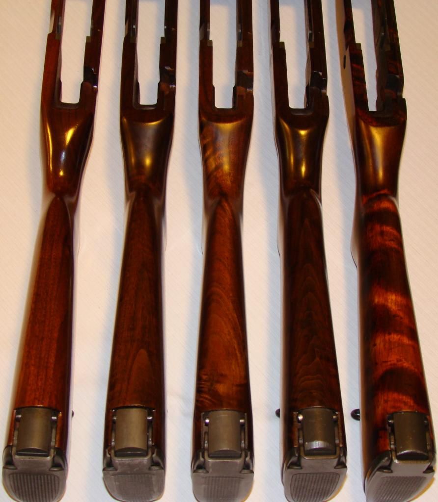

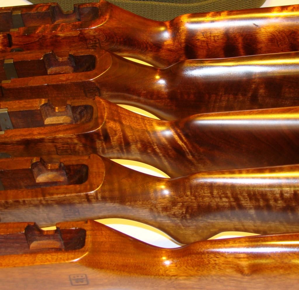

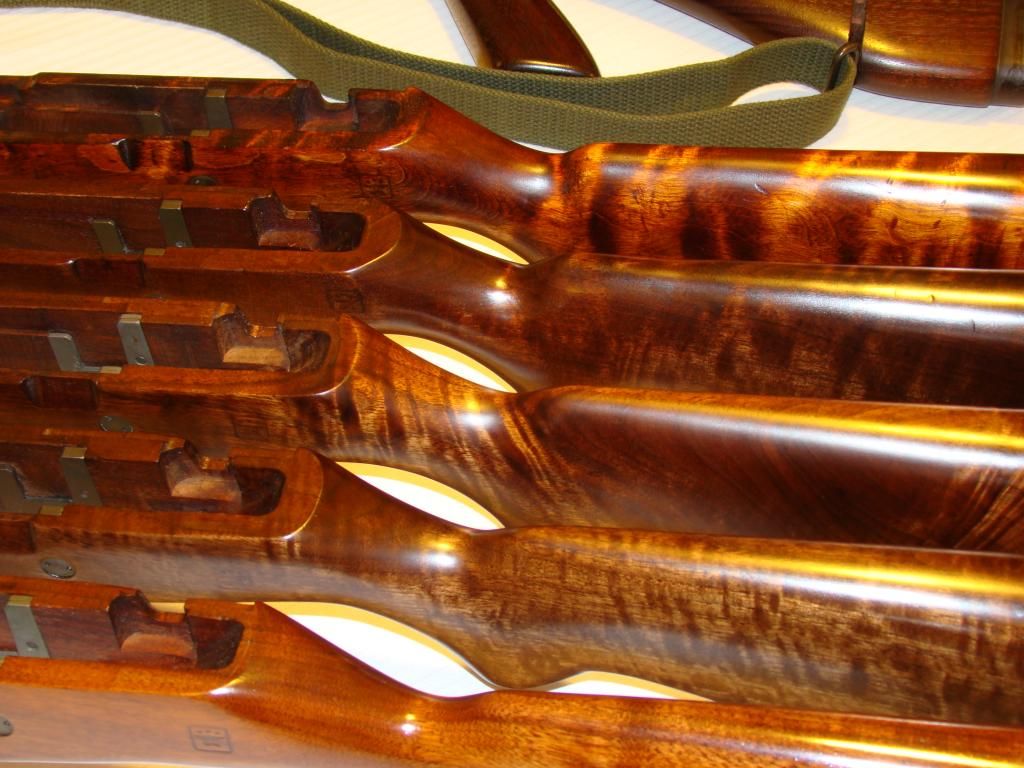

If you look closely at the Overtons stocks you will notice that they are slightly thicker in the wrist, the thinner stocks are the Winchester and the S.A. stocks. In the following pictures if you will look at the Overtons you will notice that behind the wrist(the comb) you will see a thicker round hump it is in this area that the Overton are much thicker than the Winchester and the two SAs. The comb on the other stocks come to a sharp point where the Overton is more rounded and is thicker.

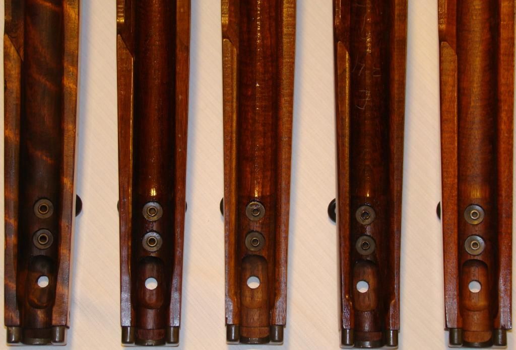

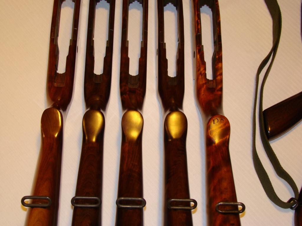

Please notice too in the following pictures that the area in front of the mag well are different. The two Overton stocks have a noticeable diamond shape, the two SA. stocks are very slightly round and the Winchester in front of the mag well is flat running almost out to the sling swivel.

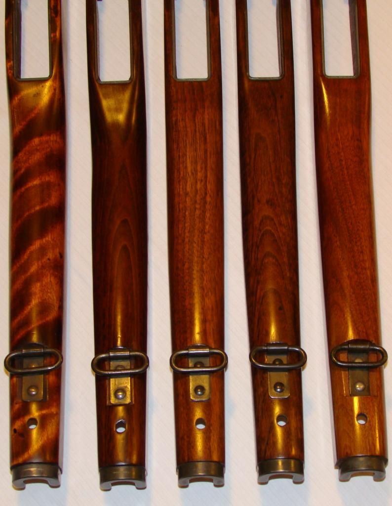

10,141 Posts

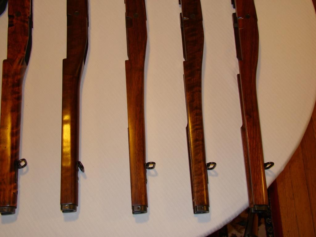

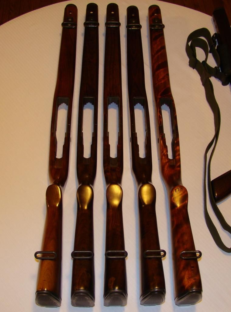

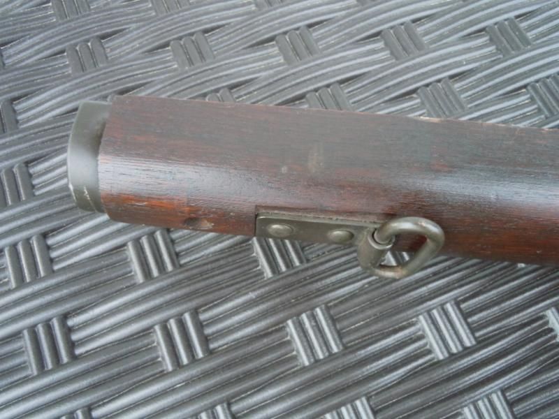

In the photo below I would like for you to focus your attention on the sling swivel area, you will notice that the Ovetons on the left have a cutout for the sling as does the Winchester on the far right, but the Springfields are round and their cutout area is almost unnoticeable.

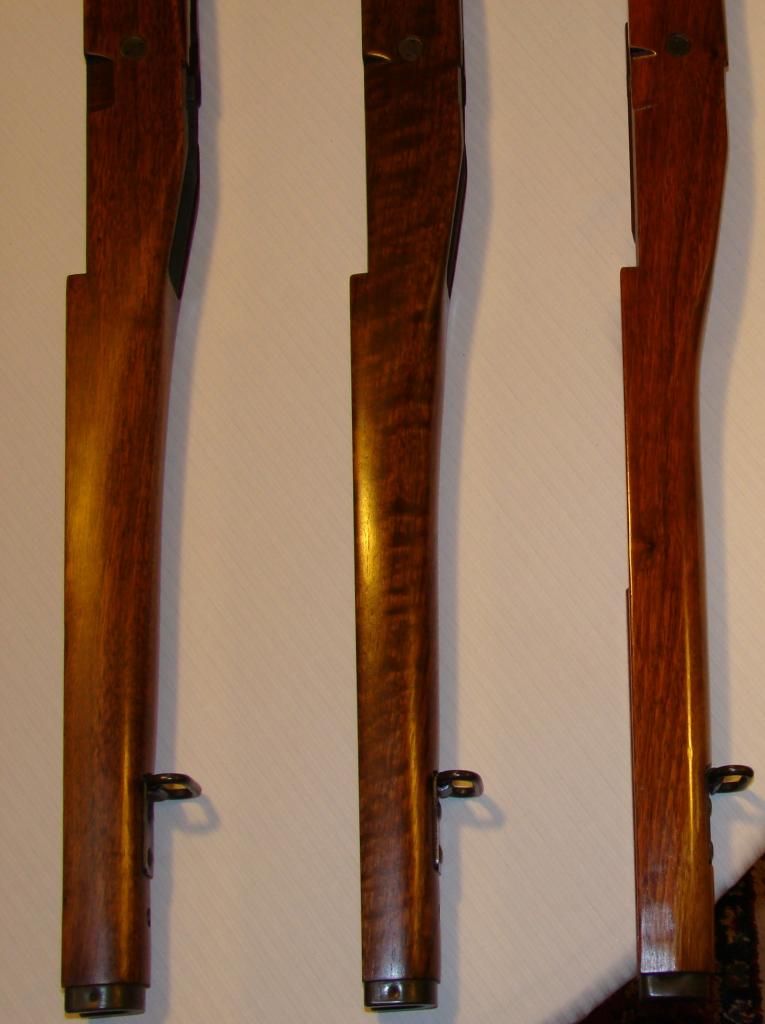

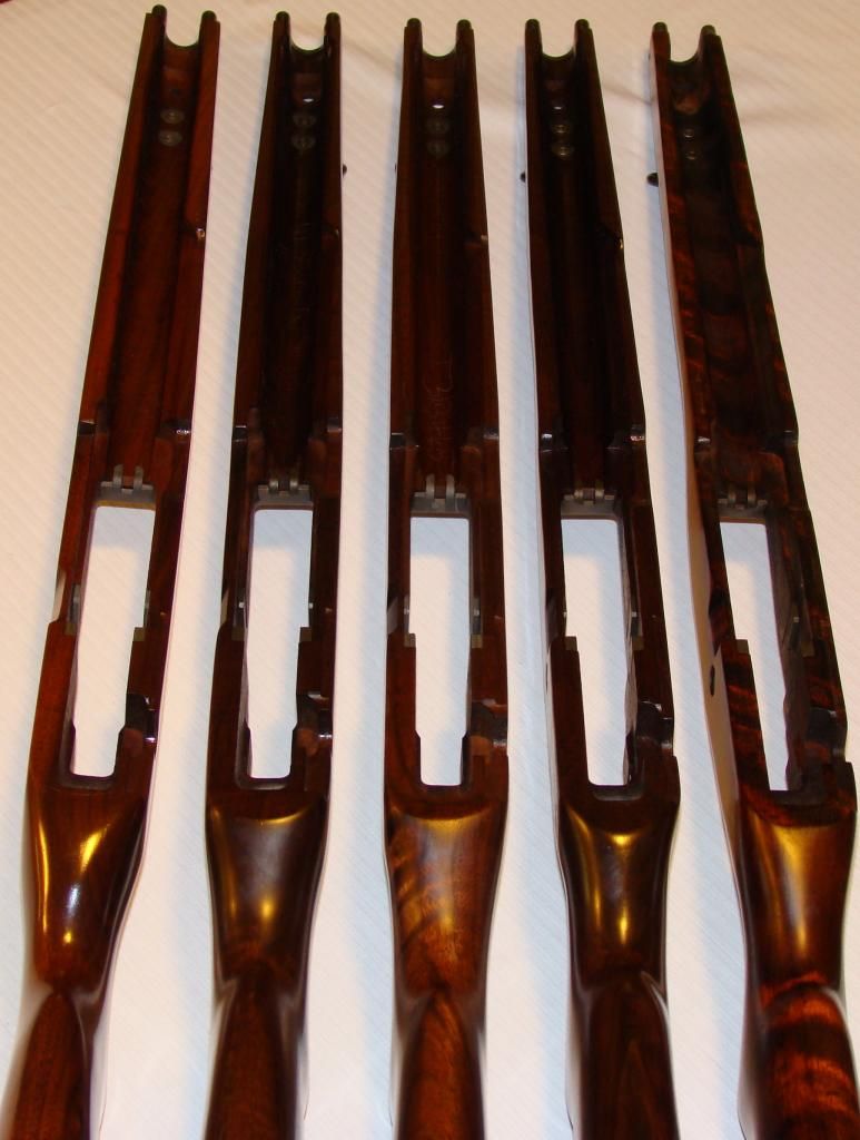

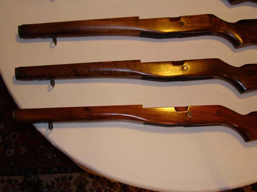

In the next set of photos you can see how much thicker the Overtons are(the two on the right). Look at the rise in the stock above the wrist area and you can see how the Winchester and the two SA.s come to a sharp point, where the Overtons are thicker and more round in shape(like a camels hump).

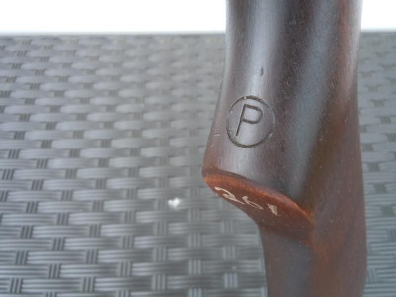

In the last picture you will notice the receiver number written in the barrel channel( the two in the center), this is a specific Springfield Armory trait as they were the only ones to do so.

My preference is HRA because of the thickness. Better for shooting with a sling. If you want a slimmer profile then SA or TRW would be your best choices.

Not entirely true Jason, while the SA has a slimmer profile and so does Winchester(not counting big red), the Overton(TRW did not make stocks) stocks are much thicker in the wrist and forearm, as observed in the photos.

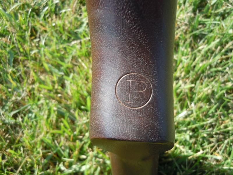

The Sacks has the half moon crimp, rafter S and a skinny arial P proof (not the normally seen Dolly Parton arial P)
I got three other wood stocks here that anyones guess is as good as mine. But one does have a serif P proof, the others the Dolly arial P proof

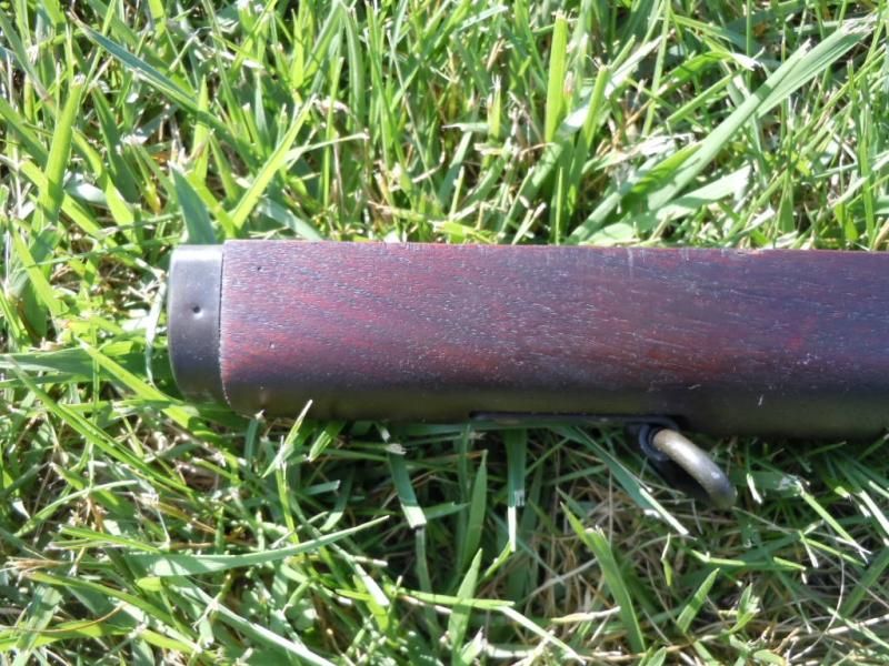

This is the only one that I did not work with and it came from Doug Carlton (Wade) and he did a great job of preserving the cartouches.

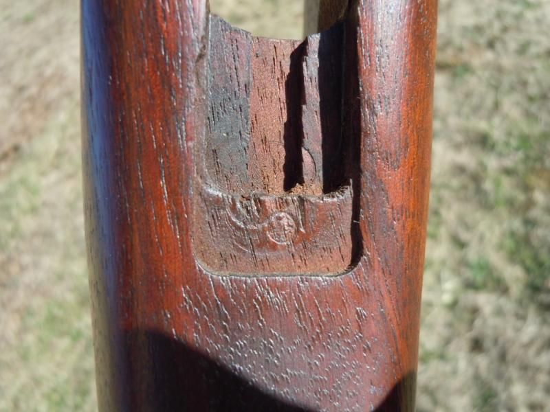

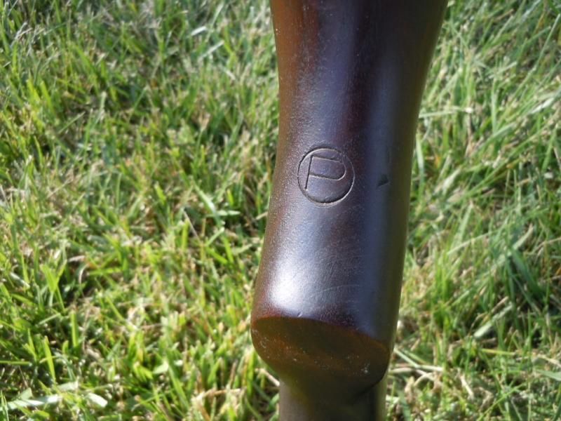

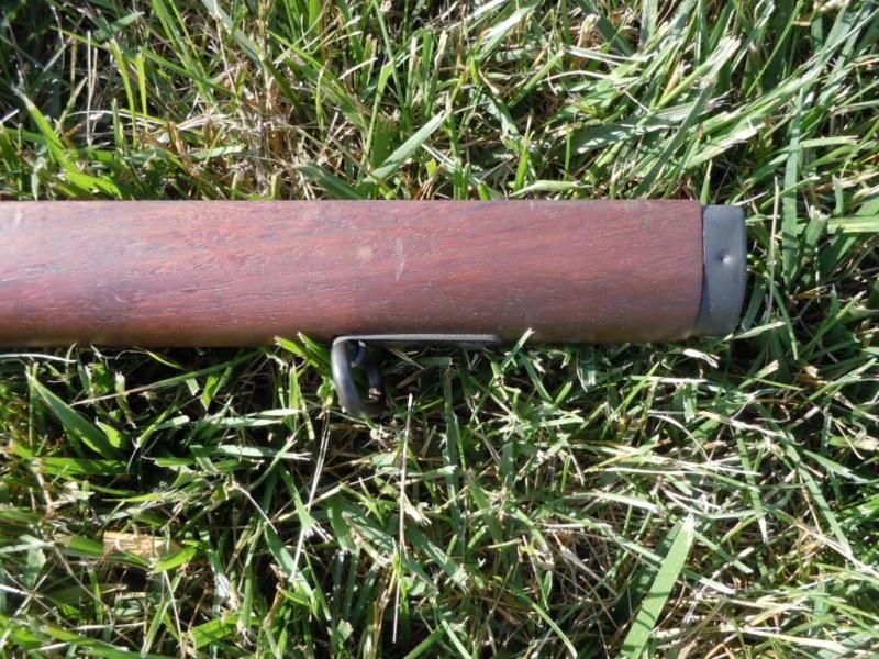

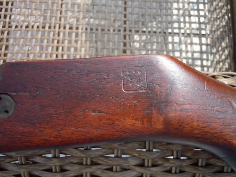

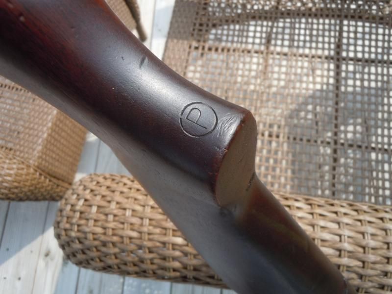

Trw overton walnut

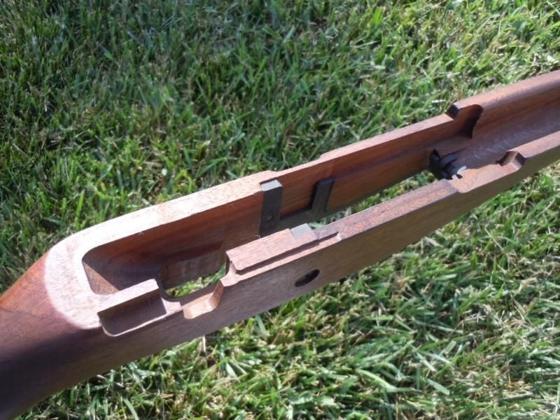

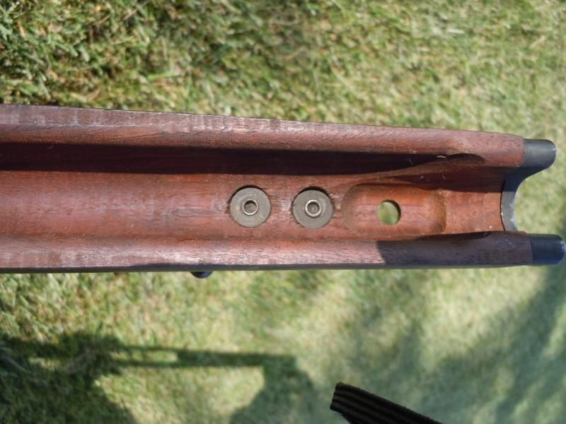

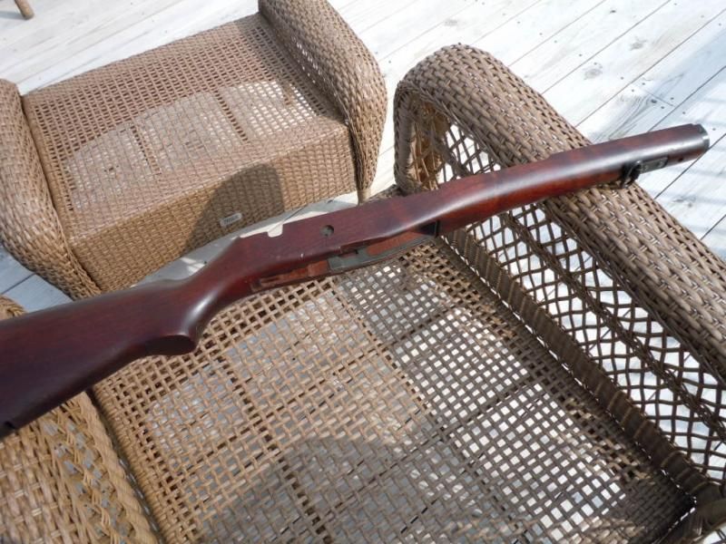

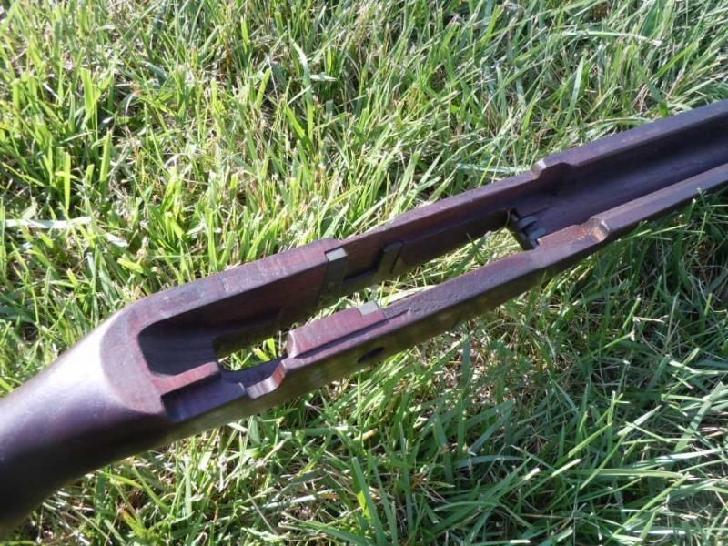

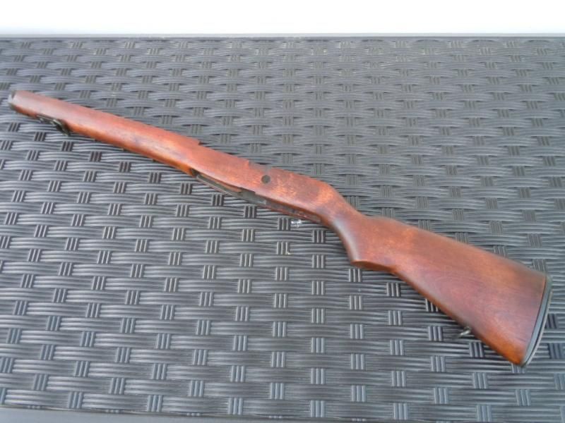

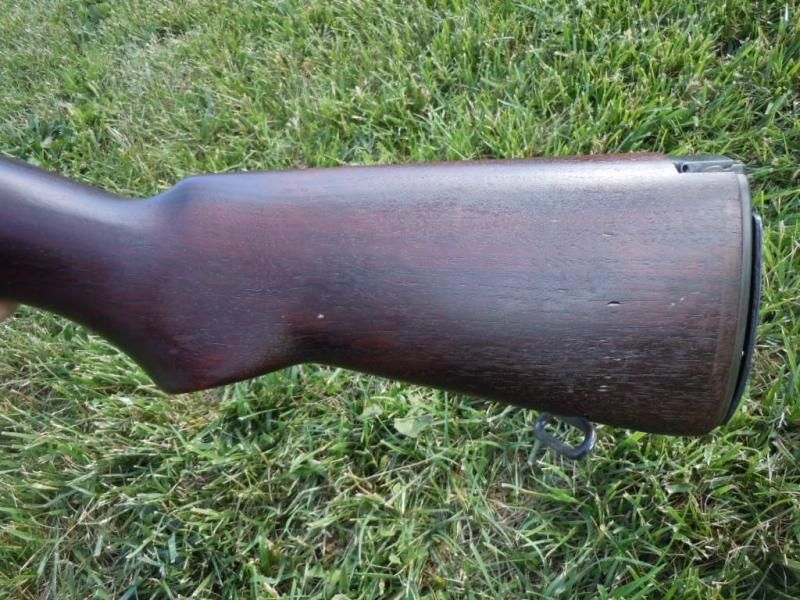

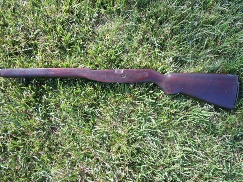

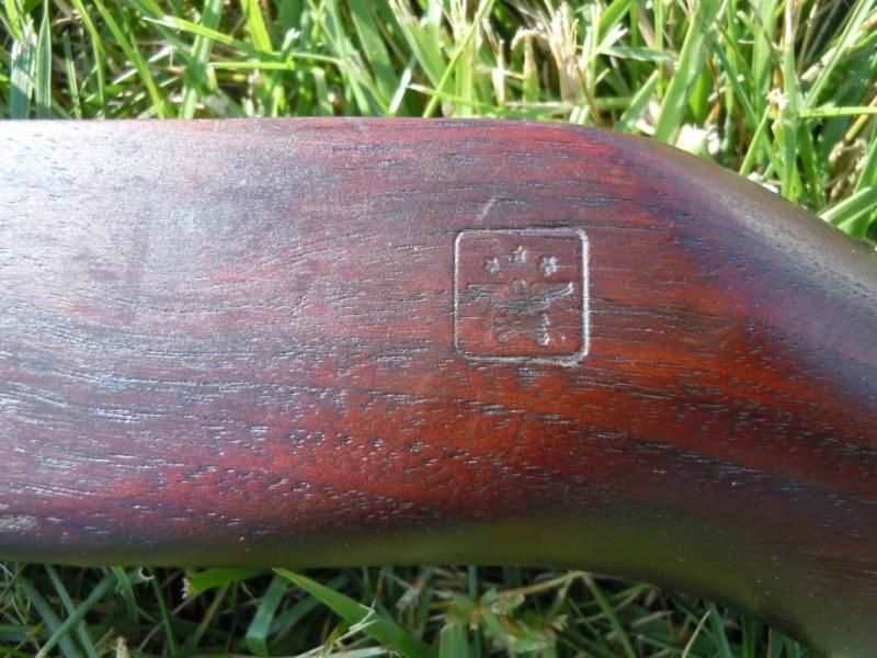

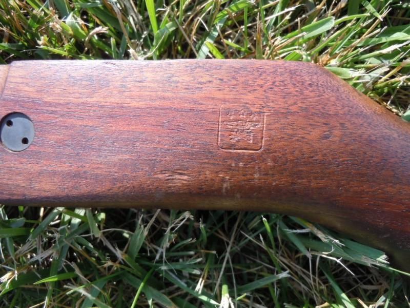

I'll add some pictures that show decent identifying characteristics . Here is an original as removed from USGI M14 made by S. E. Overton Co. ,Its a walnut variety .
Chiseled comb
Large radius back porch and radiused top handgaurd deck corners
Lightly struck pin punch ferul
High arch DAS cartouche
Large wide flat san serif (P)
Distinct flat sides
