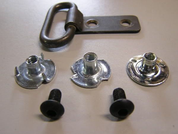

Front Swivel Hardware
I use 10-32 x 1/2" Pan Head screws [hex head] for wood stocks and 10/32 x 3/8" for fiberglass stocks. You can match the Pan Head Screws with T-Nuts.
Go to you local Ace Hardware if you have one and they will have them in the hardware area in the trays of special [screws, nuts, etc]. Some of the T-nuts have the tabs and you will need to bend those off [I grind mine down as well so they fit to the bottom of the stock and sit very low - no interference with the gas system]. It will look good and function fine.

They are in fact 10-32.
I have flat socket head screws I can send you. Black oxide finish. They are long, so they will need to be cut.
