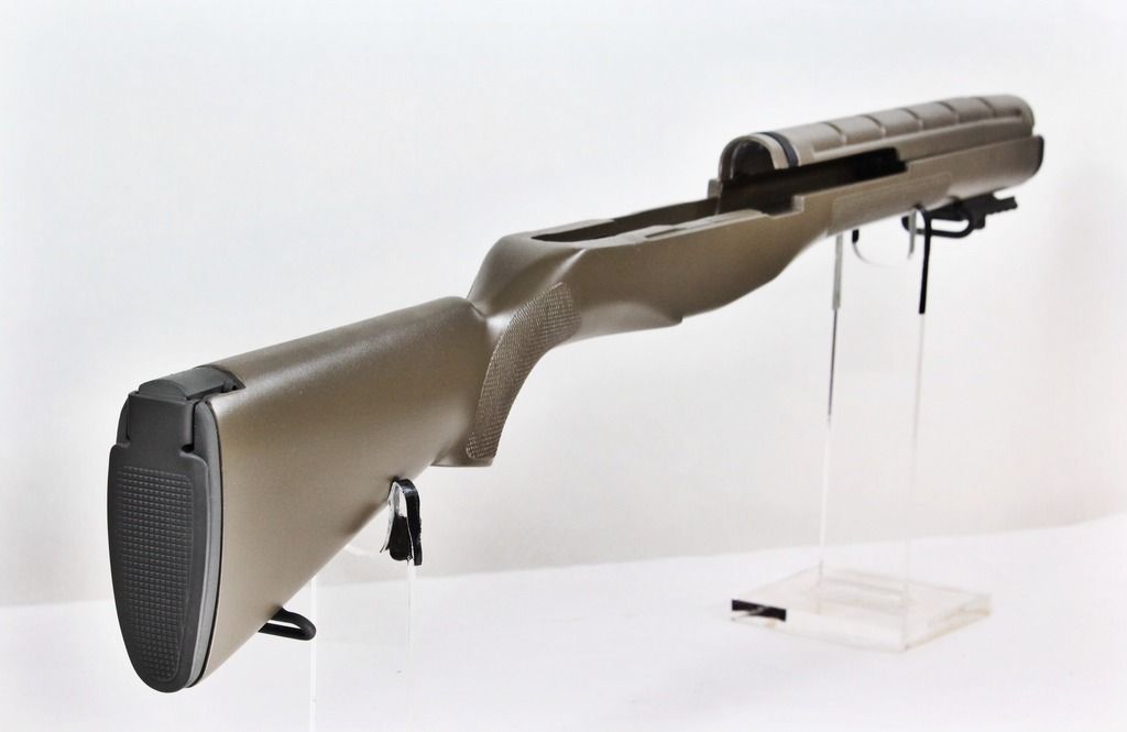

I disassemble the butt plate (separate the flapper from the back plate) - I degrease, blast and repark the flapper as it is made of steel. The backplate is aluminum - so I blast those as well and repaint them with Aluma Hyde II - Dark Parkerizing color. I re-assemble and they look really nice! The Aluma Hyde II is epoxy and dries hard and will resist solvents. Getting the orginal USGI finish was just too expensive when I investigated that.
Here is one on a USGI Fiberglass Stock I just finished. I painted the stock with Aluma Hyde II Earth Brown.
