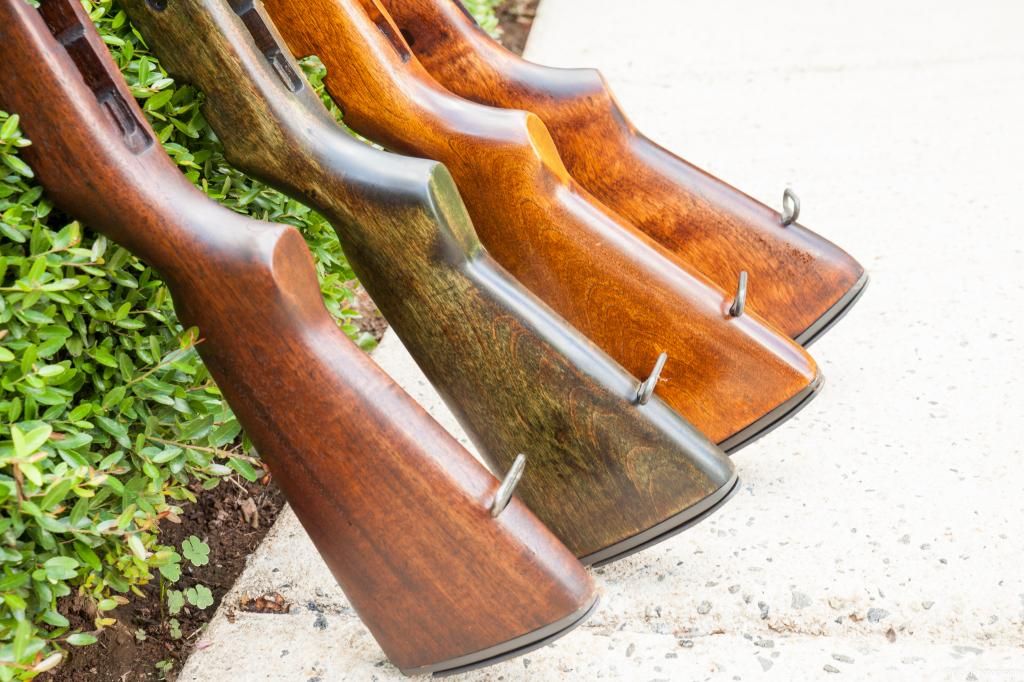

Custom II - Depending on the Walnut stock you receive [actual grain & color that you get from Fulton] many times you can just prepare the stock to the smoothness you want by lightly sanding as required [start with 150 and work up to-220 up to what you like etc.] and not stain it at all as Walnut will often finish dark(er) by just by adding teak oil and following the information in the teak oil experiment link that Doug Carlton has provided.
One advantage to not staining the stock is that if you use it hard [as you have indicated] and bang it up you can re-sand the stock later and just repeat the teak oil process (with buffing etc.) and be good to go again without worrying about matching a stain etc.
You don't have to use teak oil and many have done fantastic finishes using other techniques - well documented on this site, it is all a personal choice and what you have comfort using [I prefer teak oil but its only me].
Your material list might look like this- [sand paper [only as needed - 150, 220 for sanding and 320 -> 1500 if you use the process in the teak oil link provided], long sturdy qtips, a tact cloth to get stuff off your stock, acid tone or denatured alcohol to clean prior to applying stain or teak oil, if you stain [I like the stew mac stains and if you want dark I would use a combination of tobacco brown with a light coat of vintage amber - that link has been provided too], then for buffing you will need a drill or grinder with a 7"-8" buffing pad to buff the stock and briwax to put a protective coating on the finished product. Oh yes and a lot of patience as you never want to rush the refinish process - just take your time and go slow!
Below find two stocks finished with tobacco brown and vintage amber and teak oil.
Again - many, many different ways are out there to refinish - that is why your head was spinning and you have many options. Most that are good at refinishing or finishing have found their way through a lot of trial and error to get it right.
Good Luck - M1Army and post some pictures!!
Walnut #1 - Tobacco Brown and Vintage Amber
Walnut #1 - just the rear stock view - 1st stock
Walnut #2 - Tobacco Brown and Vintage Amber
Walnut #2 - just the rear stock view - 1st stock
