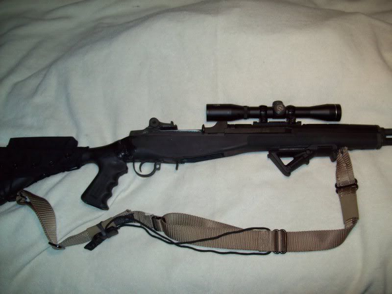

Recently got a Socom 16 and wanted to do a Scout configuration ala Col Cooper( I've wanted to for a LONG time) and make it as reliable( and accurate) as possible.
We have hogs and gators and bear( oh my!), so this will fit that bill.
I put a long eye relief 4X32 NCstar scope on it, got some CMI SS mags( Florida humidity) and a Blackhawk cheek pad. Mag carriers are kydex, from SKD. The sling is from T.I.S. http://www.tacticalintervention.com/
Now, afa reliability, I did a little trigger work- I replaced the stock hammer and extractor with forged ones. I polished up the front hooks of the hammer and the matching surface of the secondary sear.
What that does is give me a nice, smooth trigger pull. I didnt mess with the back hooks and primary sear, as I want a solid hook up there( catches the hammer when, if you hold the trigger back after a shot). I put a Chrome alloy spring in, so the perceived pull is lighter, but mainly it's a smoother and cleaner break.
I also polished up the front face( where the bolt hits it in recoil) and the side( that rubs against the housing and safety) and it's mating surface.
I greased it all up and it's nice and smooth.
I also polished up the runner where the op rod rides and the face of the mag catch/release, so the mag goes in /out good.
Then, inspired by Lazerus, I decide to add a pistol grip to it. I cut the back off and matched a Choate pistol grip from a Winchester Mod 1200 to it
So this is the result
I shimmed the GC, but there's still 1/8" gap when the gas plug hits the piston(when screwing it in), so now I need another piston, or find someone with a lathe to take it down.
Also, now am looking for lighter loads for CBQ work.

How is that AFG working out for you??
Just out of curiousity,
what length shirt sleeve do you have??
I tried the AFG my self on our new Alloy EBR stock,
and while I liked the angled fore grip concept,
I found AFG was located too far forward to balance properly for me on a shorty 14.
It actually slowed me down on my CQB practices.

Works great....in 3 gun, the faster folks hold out as far as they can, for fast muti target aquisition. That's what works for me....speaking of balance, my SOCOM 16 balances just in front of the mag( how many folks balance their M1A?), so right there( where I have the AFG) is max control for me. Keep in mind, I'm holding the pistol grip, that pushes the center alittle forward, so that the AFG is just forward of center.
BTw, not worried about zombies, but if a raging mad 300lb feral hog with 6" tusks or mamma bear with cubs charges me from the brush, I want to be able to control that rifle, get it on that noggin and put several rounds into it before it gets to me.
AFA pistol, I practice one hand, off hand and from the hip, as that's more realistic for me.... and I use laser, too.

Btw, before I attached the AFG, I screwed and glued the rail( that the AFG secures to) on with JB weld.......I also went ahead and painted the inside of the forend with JB weld as well, to stiffen it up.
curious..some questions...I have on order carbon fiber tape and haven't decided which epoxy/resin to use...
>> which stock did you use?
>> did you notice any perceptable stiffness in the forearm with just the jb?
>> did you weigh the stock before and after to see how much weight was
added?
>> how thick of a layer of jb do you think you created?
>> have you tested yet for accuracy improvement? before...after?
