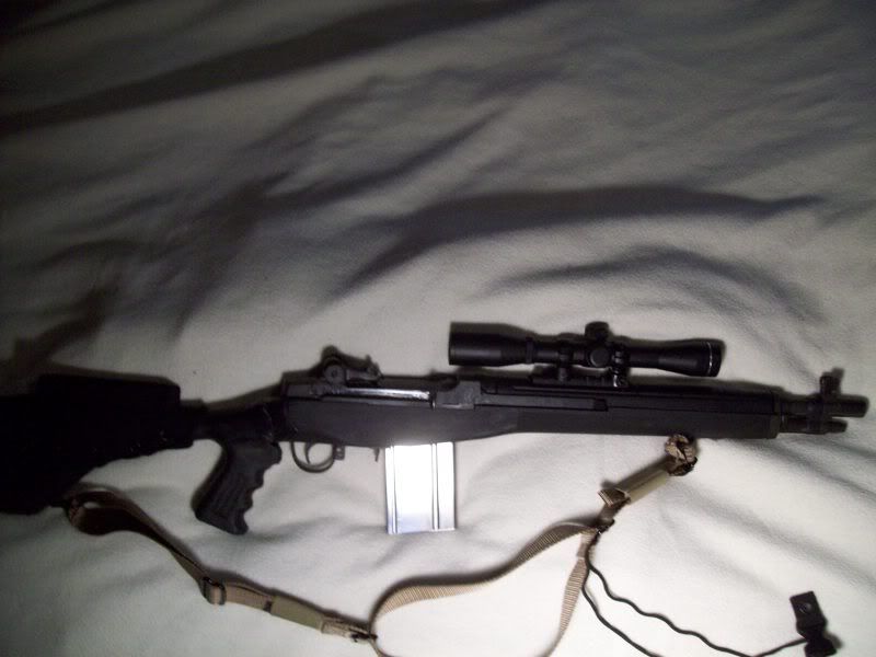

Recently got a Socom 16 and wanted to do a Scout configuration ala Col Cooper( I've wanted to for a LONG time) and make it as reliable( and accurate) as possible.
We have hogs and gators and bear( oh my!), so this will fit that bill.
I put a long eye relief 4X32 NCstar scope on it, got some CMI SS mags( Florida humidity) and a Blackhawk cheek pad. Mag carriers are kydex, from SKD. The sling is from T.I.S. http://www.tacticalintervention.com/

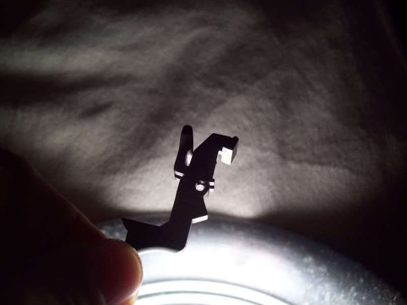

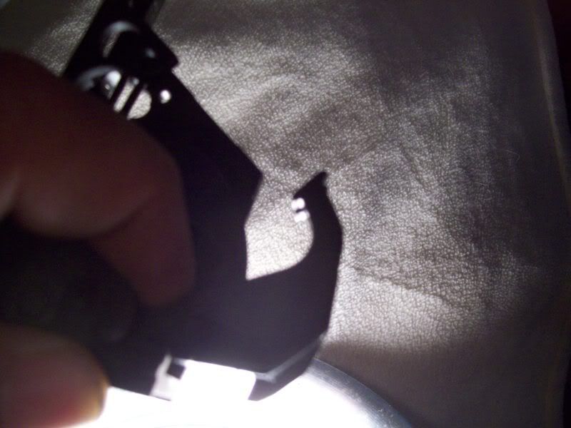

Now, afa reliability, I did a little trigger work- I replaced the stock hammer and extractor with forged ones. I polished up the front hooks of the hammer and the matching surface of the secondary sear.
What that does is give me a nice, smooth trigger pull. I didnt mess with the back hooks and primary sear, as I want a solid hook up there( catches the hammer when, if you hold the trigger back after a shot). I put a Chrome alloy spring in, so the perceived pull is lighter, but mainly it's a smoother and cleaner break.
I also polished up the front face( where the bolt hits it in recoil) and the side( that rubs against the housing and safety) and it's mating surface.
I greased it all up and it's nice and smooth.
I also polished up the runner where the op rod rides and the face of the mag catch/release, so the mag goes in /out good.

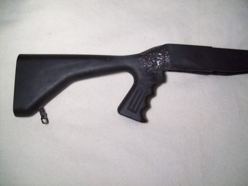

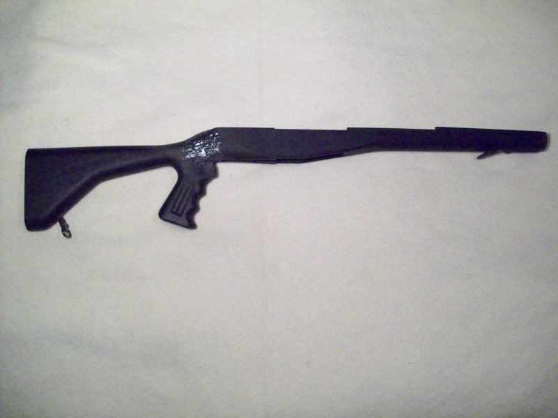

Then, inspired by Lazerus, I decide to add a pistol grip to it. I cut the back off and matched a Choate pistol grip from a Winchester Mod 1200 to it
So this is the result
I shimmed the GC, but there's still 1/8" gap when the gas plug hits the piston(when screwing it in), so now I need another piston, or find someone with a lathe to take it down.
Also, now am looking for lighter loads for CBQ work.

That's a good looking rifle. I like the custom stock.
Thanks , I wanted something as light and handy as I could get, without breaking the bank. I saw what Lazerus had done to his rifles and talked with him awhile and decided to try it.
This is what it came off of
I just put the wood stock back on the Winchester( since the Remmy is my primary SG).
I'm pleased with the results, it's handy, light and responsive( and puts the middle of my finger tip pad on the trigger) and I can spend my money on forged parts.
