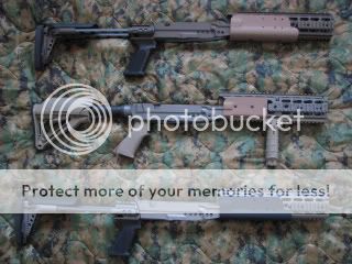

Here you see are three Sage EBR Stocks waiting for such builds.
Sage USMC M39 EMR (Top)
Sage Mod 1 (Middle)
and soon to be the USCG EBRM14 T the Sage NSG (Bottom).

Solid decision, very solid.....Zip, that is just too cool....three EBR stocks in one picture....Now you are driving me nuts...
