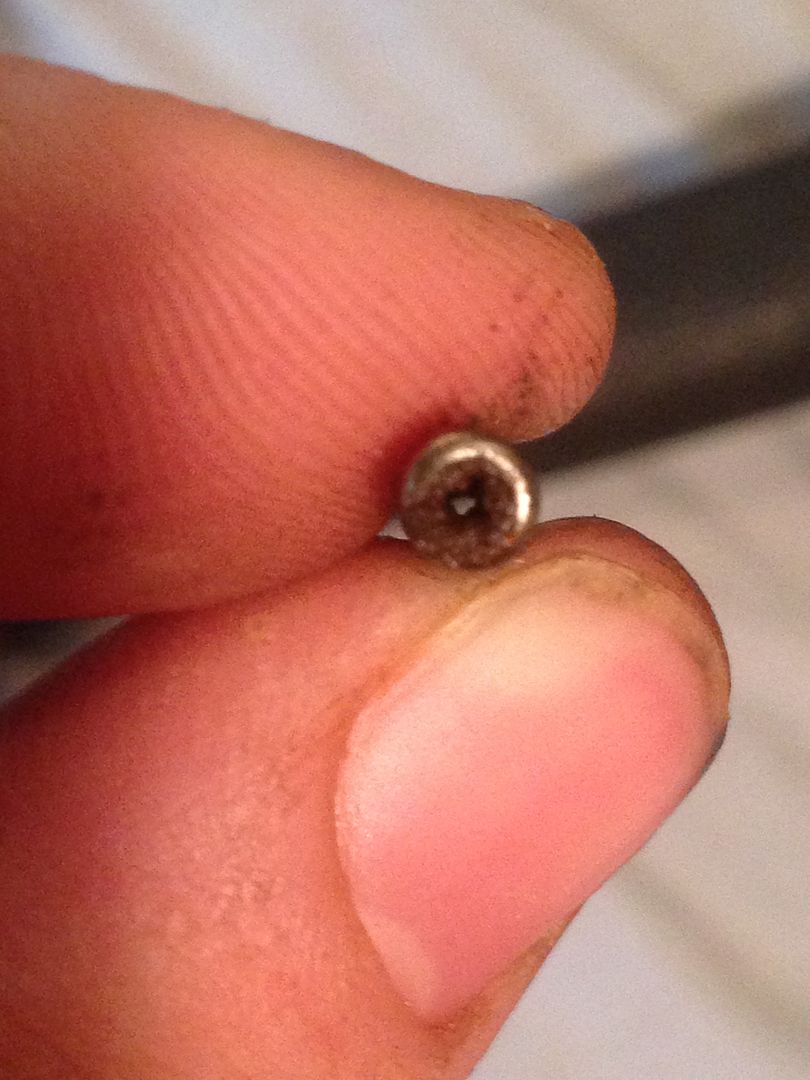

That was how my Spring looked after taking it out GI3 (sorry for phone pic)

I'd only punch it out (1/8" punch) if there is a problem. Does the mag latch feel funny when you move it through its range of motion? It should be smooth and silent with no wobble on the pin.
Mag is good with the stock, I took out the spring and cleaned it up and put it back in (cleaned insides to) and now it doesn't make any noise or "crunchy" sounds GI1
