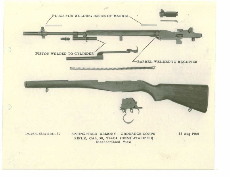

I don't know enough about the T44E4 and the development to add much to this discussion directly. However, in my study of the .30 cal Browning belt fed series, it seems that there are some photos of development models that were likely one-offs, or one of very few, and they vary in many details from the early issue guns and production models. In some cases, one knows that at least one gun was built that way, because there is the picture. Might well BE only one. Also, I know of examples of early manuals that used prototype images, where the guns varied in detail from what the troops were being issued from the production line.
Not sure how many T44E4s were actually produced, but it seems entirely normal (to me) that some did get the scope mount feature, while some did not. Maybe early versions, maybe they just tried it both ways at the same time. Interesting to note that the images of the one (above) that show the scope mount provision is dated EARLIER than the one with no such provision, by about 6 months. That doesn't prove anything, but it does tell us the scope provision existed before 1955!

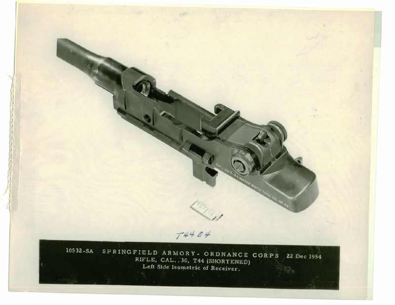

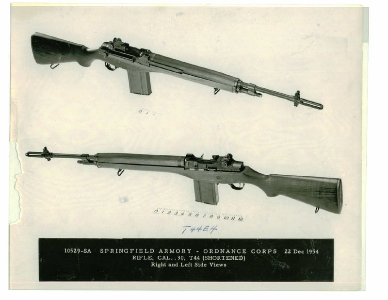

Finally I remembered how to upload larger sized photos from Photobucket instead of the small thumbnail versions!!
Anyway this is an interesting subject almost like "which came first, the chicken or the egg"? It does look by this 1954 dated photo below (Mathewson Tool Company prototype) that the receiver with the scope mount is labeled a T44 (someone wrote in ink T44E4), and in the later 1960 dated photos from M1Army it was labeled T44E4, which is also correct. And to complicate this further, the T36 trials rifle in 1950 had the scope mount provision.

So, in summary, it appears from my reading of Blake Stevens book that the Mathewson Tool Company T44 prototype was quickly renamed the T44E4, it originally was designed for a scope attachment, and the non-scoped provision version trials rifle by Springfield was also called the T44E4. The receiver made by LRB appears to be a faithful reproduction (some cosmetic differences noted) of the Mathewson Tool Company T44 / T44E4 until it was renamed the M14.

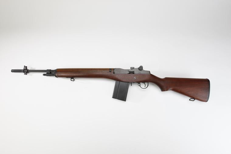

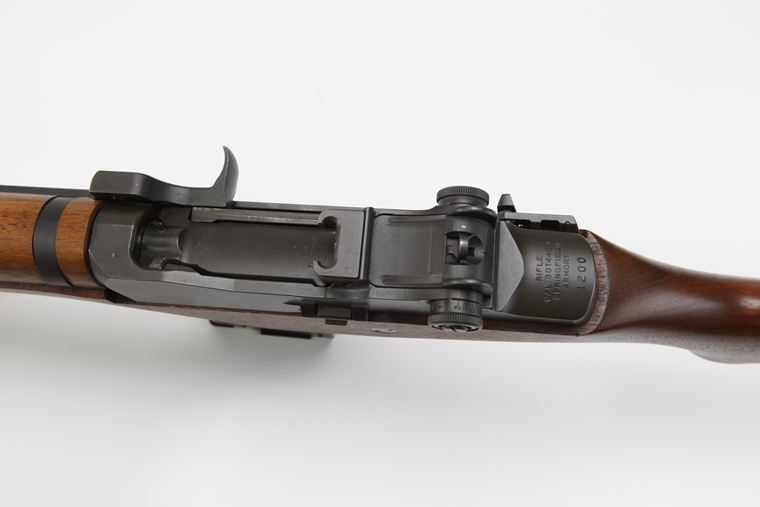

I have never seen these pictures of what looks like a scope mount on the side of a T44E4 receiver. The pictures on the NRA museum show the left side flat. I though that the tapped hole and the 2 grooved rails on the left side of the m14 receiver was to attach a grenade launcher. You are calling this one a scope mount so maybe like the dates on the pictures indicate there was a earlier version made just for a scope mount. If you look closely you can see that the left side in the picture is not like left side of a M14 receiver. Anybody out there got any knowledge of the 2 different mount styles on the left side? Anybody got a print, I could make some?BIGOK
