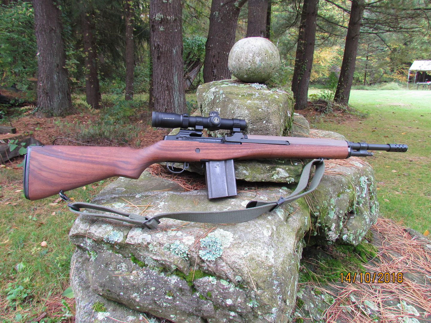

Hey Art,
Do you go stock hunting, or what?
Every time I see you post a picture they have the most amazing grain/appearance. Good stuff.
Vic
PS - on this topic of mounting scopes on M1A's - any updates out there for CMP shooters?
Yep, been hunting for just the right stocks for all my rifles for over 50 years. Some are great, others not so much.
Found this one on another rifle at Camp Perry a couple of years ago at the Bula booth. I requested this particular rifle be built in .450 Bushmaster with the stock I had seen and low and behold, they showed up the next day and completed the build as I watched. Great gang to work with.
