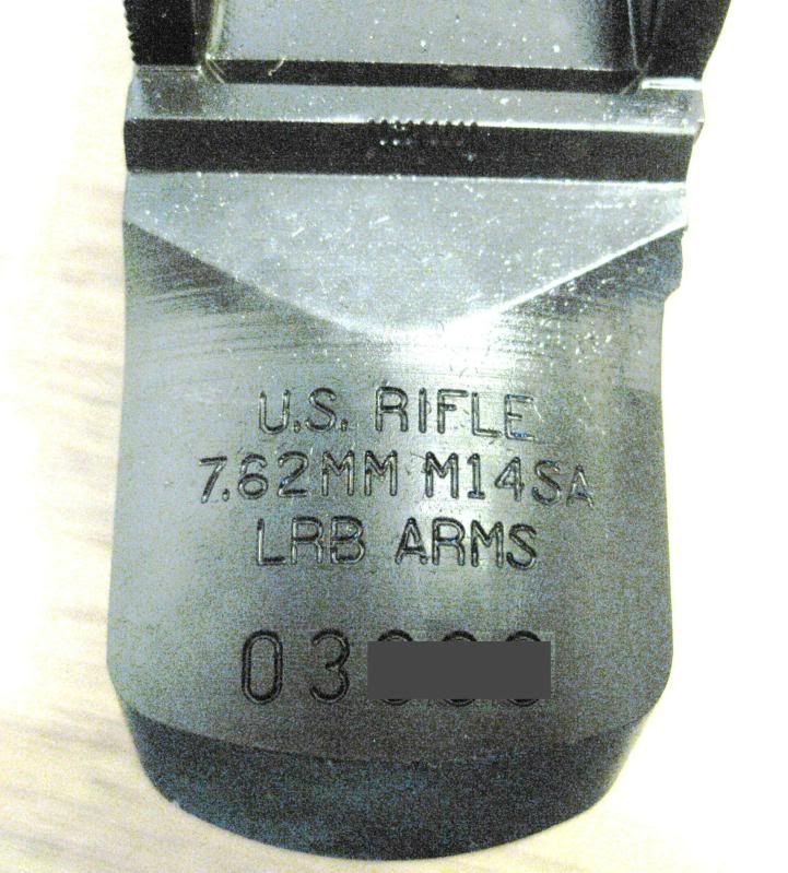

I received my LRB receiver a week after ordering it. I was under the impression I would have to wait months to get it so I was pleasantly surprised at how quickly it shipped. DI2
I don't know if they have them sitting on the shelf waiting to ship or if someone cancelled their order but I got mine fast and I am happy. GI1
Now I have something to put my CMP TRW parts kit on. GI2
I photoshopped the last two digits out but it is a four-digit sn. I set it in a CMP stock to check fit. Very snug and flush. The finish is beautiful. Can't wait to shoot the finished product. GI1

Get ya some dial calipers and take a look at some of the key dimensions (barrel ring, safety bridge, sight pocket, etc) before you do anything with it... Not doing that bit (and possibly continues to bite) me in the ass, and I'd bet money yours came from the same batch as mine.

Rip described it best in the post I linked to, and I should probably defer to him for the proper values and receiver anatomy, but here's my go at telling it:
The biggest issue was the receiver bridge the barrel threads into. My receiver arrived seven thousandths short of the smallest permissible width of that band, and as a result, every barrel we tried could be overtimed by hand, before we even put appreciable torque on it. Ripsaw and Geeck fixed that by adding some crush on the shoulder of the barrel, but that short dimension takes everything else with it seven thousandths, causing the barrel to protrude farther back into the receiver, the bolt to impact the barrel, and limiting what you can do with the headspace. There's also a chance that the rear sight pocket is out of spec as well, but the jury is out until I get a chance to swap the current sight out with another (kudos to 2treeline for helping me out).
I'm never taking possession of another receiver without first making a checklist of critical dimensions and taking a good pair of calipers with me to my FFL.

After reading your post I got my LRB receiver out and test fitted the barrel. The barrel I am using is a barely used 1963 TRW. It threaded in nicely by hand with very little resistance. It bottomed out about a quarter of a turn from TDC/index so I think at least that much will come out okay.
I also test fitted the bolt, also a barely used TRW part. It was rather difficult to wiggle in and was tight going into battery but otherwise slid along the grooves unencumbered.
I would have made the drive to Darlington today (about an hour's drive) but I just came off a two week stretch of work and I'm a little frazzled right now. GI3
Thanks for all the helpful comments. I will come back here and post up some pics of the finished rifle when I get it done. GI1

No doubt, but the issues we were referring to are significant. If you take into account the amount of hours required to straighten them out, I doubt anyone could afford to pay an armorer to do it, or that you could find one willing to do it, rather than send it back.
I failed to mention the receiver safety bridge location in the thread, because by checking the firing pin protrusion and other factors, I deemed it allowable for safety. It was in fact .005 out of spec. But, we are not talking about G.I. receivers here, which is where the specs come from. The firing pin has play allowable for spec, then factoring in the bolt location after lapping and target headspace, and the primer seating depth, and he is good to go.
