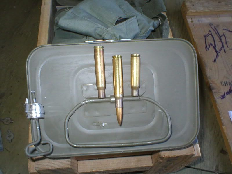

For the record there are no 'Greek' enbloc clips. The enblocs that the Greek HXP comes on are made by countries like Germany, Holland, France, The Netherlands..............probably more countries (Plus USGI and US commercial). Later HXP also has the same extractor groove geometry as the 7.62X51 (.308). That's why the 'dimples' dimensions are different.
Left: USGI LC .30-06 Center: Greek HXP Right: 7.62X51
