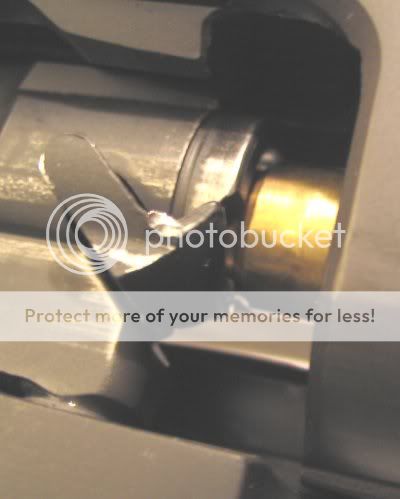

(3) Push the bolt forward so that the rear of the tool is against the bolt face and the ear is under the bottom of the extractor. Below, you can see where the extractor has been pushed outward by the tool:

(4) Place your thumb on top of the extractor. Rotate the tool counter-clockwise (from the buttstock end) while holding the extractor with your thumb. The extractor will pop past the detent. Alternately, you may simply cover the top of the action with your hand to keep the parts contained as they fly out of the bolt. I like to use my thumb as it offers more control.
Here's a front view with the extractor popped up past its detent:
