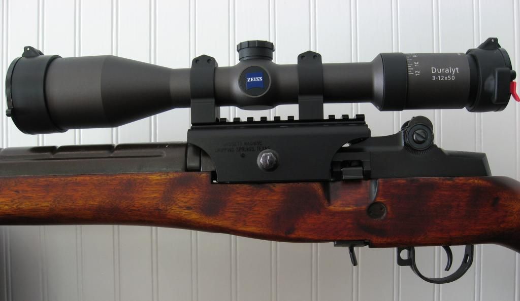

I have the low mount on my SA NM. Based on forum advice. I like it. On and off for iron sights is no problem. Had to get a strap on cheek rest for scoped shooting.
I would talk to Bassett with the optic info handy.
I have no problem with brass ejecting either.

Low and then probably medium rings for scope objective clearance. I was using lows and a sadlak mount with a 56MM objective and it still cleared.
3,420 Posts
Basset low mount works great for me! If you are concerned about the clearances for you optic of choice, call or email them. What size dia is on the front of the scope that you are thinking about?

Bassett Low Picatinny Mount with Burris Xtreme Lows
I use Burris Lows (1/4") for my Vortex PST Viper 2.5-10 x32 on the Bassett Picatinny Low mount.
The rear iron sight is set at 100 yds. It will just clear the magnification adjustment ring if I were to position the ring over the elevation sight.
Burris Xtreme Mediums are 1/4" higher.
I installed a cartridge deflector under the scope to protect the knob from ejected cartridges. I don't seem to need it but good insurance.

I run a Bassett High Picatinny, with Low Burris Xtreme Rings and a 56mm Objective Lens

Does the high mount have enough clearance to remove the bolt if needed
The real benefit of the Bassett is the ability to remove the mount entirely from the rifle, then reinstall it with very little POA/POI change.

I have a Basset low picatinny mount with Warne Maxima medium rings and use a TNVC cheek riser, I can use the iron sights without removing the mount but the top portion of the front blades are not visible, no biggie for me. I'm finding that there is very little to no re-sighting in the scope after the mount and scope has been removed. I really like the setup but may try to find some rings that will lower the scope just a bit.
The mount is slick, it comes off in just a couple of seconds and is just as easy to reinstall.
