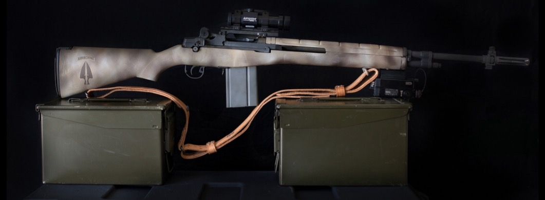

Hello everyone! As my introduction post has stated I may be interested in the near future to put an optic on my rifle. I know I will need a mount since my m1a model is the standard model w/ no rails. I was curious if anyone here has mounted an Aimpoint Pro on their standard m1a? And if so what mount is best for this optic.
From what I can see the aimpoint pro w/ its included mount sits high and I am afraid of issues coming from that.
Any suggestions or proven setups?RNGR2

+ 1 for aimpoint any optic will likely be riding high on this rifle. There are many to choose from. I have a Bassett high mount which is not the most popular. But with an aimpoint you can quickly aquire close targets and also use your irons.

I would make sure to take the spacer out on the optic mount for the PRO to help lower it down. What do you intend to do with the rifle and red dot?

The lowest profile setup you can achieve using a traditional (over the receiver) mount is an Aimpoint PRO in a low 30mm scope ring using the ARMS 18 scope mount. If you want things lower than that, you'll need to invest in a scout rail.
I like USSF06's setup with aimpoint more than scout rail. I just think the scout rail is ugly. And this setup is how the M14 was designed to have optics mounted.
I agree! It just seems out of place to have a scope or red dot right on top of the barrel.
I wonder with this low mount if the aimpoint will cowitness with the front sight.

No, the only way to cowitness a red dot on the M14 is by utilizing a scout rail.

Hey USSF06, what kind of scope ring did you use for your Aimpoint?
Also OP, if your budget allows, you can get an Aimpoint Micro and that, with it's lowest mount, should sit even lower than a PRO.

It was either a Warne or Leupold scope ring. I've used both manufacturers before, but I can't remember which one is pictured. I used the quick release version, so there is a lever on the other side that allows you to easily remove the optic and reinstall without losing zero.

Here Ya go...
Aimpoint PRO, you'll find the mount it comes with to be too tall even with spacer removed, so I set the mount aside, Vortex low tactical ring, ARMS #18 mount, and BlackHawk IVS cheek rest, and yes, Black Hawk Down was my inspiration for this rifle.
I really like this setup, but, the mount is so low you can have ejection issues like I experienced, so, I've moved the ring as far forward on the rail as it will go to clear the ejection path as I noticed some brass dings on it, yet to get out to the range and recheck...
I have 2 questions for USSF06 : Did you experience any ejection issues or had to do any tuning? And yeah, I'd like to know more about your scope ring...

I had zero ejection issues with the setup pictured. I can probably find a picture of the other side of the mount to verify if it's Warne or Leupold.
SFC Shughart's rifle was my inspiration as well. I ended up selling the SOCOM to try and replicate the real deal.
