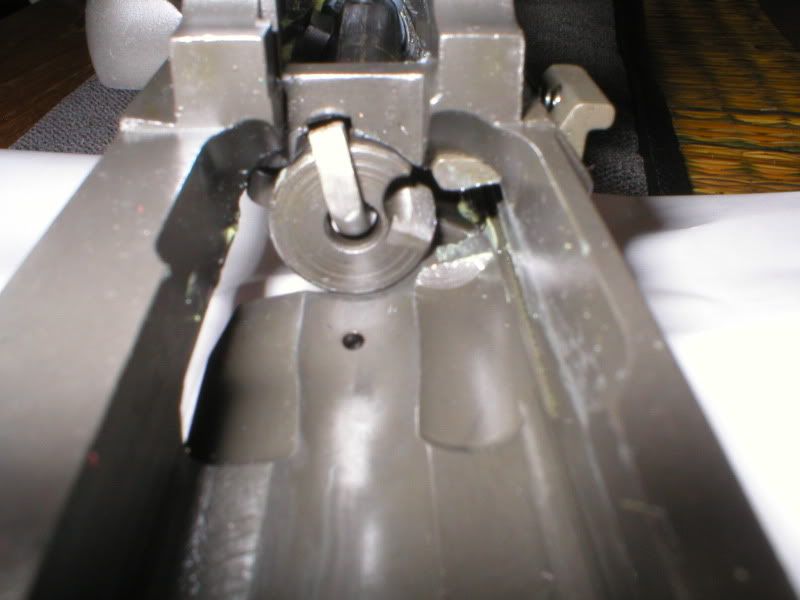

My initial impressions were that it looked very professionally assembled and had a nice, smooth dark parkerized type finish. I had purchased an 18.5" standard weight Criterion barrel and 7.62 had installed it and built the rifle from parts that I supplied. They did this an no cost to me.
I do not see any major machining marks on the surfaces that are visible when the rifle is assembled. The surface is smooth and even. Here are some pics of the build. One thing that you'll notice is that the machining of the interior of the receiver heel is not as flawless as some other manufactures. Is this a problem? I don't know, but I had originally sent my first receiver to a well known gunsmith on this forum who judged the surface of that receiver to be safe and that it offered sufficient area for the bolt to strike on. That early receiver was, if anything, rougher than this receiver and was sent back to 7.62 for some processes that were not completed at the time of initial machining. The bolt stop pin hole on that receiver was blind and once pin was installed it could not be removed. 7.62MM replaced that receiver and then as a follow up offered to build the rifle for me. Here are the pics:

Thanks for the pics. It does look as though progress is being made in the machineing. But I would still like to see the reciever cleaned up in the heel area. It may be functional but it shows they have not gotten all the steps perfected for finnishing this area. Also from your pic of the bolt roller, it appears to be touching the rail when in battery. May be just the angle of the pic though.
I will wait a little longer untill I see these areas corrected. I want to do a custom build with a custom serial #.

I am on my 7th graveyard shift and am not bubbling with positive emotions right now, so may seem a bit muted. The build looks good and the proof will be in the shooting.
And yes, the bolt roller shot is just the angle, there is clearance on both sides. For some reason when I down loaded the pics to Photobucket the forward shot didn't make the trip.

My receiver looks better in the heel area than that one.. I see some hand work on mine also.. I'd not be happy with that hogged out look.. if it was mine.. I want 762MM to be in the market and be a competing company with SIA nad LRB. The more companies making this stuff the better off the shooting community is.. I'm glad they are making new parts that's what the M-14 industry needs a shot in the Arm.. one reason the FAL has such a larger market share it the sheer numbers of parts.. 10-1 to that of the M-14.. What I don't want from 762 is Poor products...put on the market because they didn't want to fix a problem.. it will end up costing them in the long run if they do that.. a happy customer tells a friend or two about their product/experience and unhappy customer tells 10-20 people about the very bad experience..don't buy from them etc... if 762 doesn't get their act together they'll be gone like Fed Ord. I'll post some pics of my receiver when I pick it up.. B2B

Here's some better shots of the bolt lug lock up areas:

It wasn't the sides I was refering to. It is the bottom where it appears to contact the rail.
I'm with you. The roller looks like it is touching the rail. In one of the pics it looks like some meat was removed from the rail to relieve it.
I missed that!! I will give it a look when I get off duty and go home. Probably won't be able to get to it until the afternoon.
Good catch, guys!! I found this post from an earlier time. Sounds easily taken care of, but I wouldn't expect to see this on a new build. I'll try the paper test tomorrow.
http://www.m14tfl.com/upload/showthread.php?t=34508&highlight=bolt+roller+contact&page=2

I just received my receivers on December 7th...how fitting.....the bolt roller relief cut-out area, to rectify bolt roller rail impact, is good to go in all five of them.......the receiver heel cut is very concentric and a smooth radius 360 degree cut at the proper angle that is diminished to nothing at the bottom of the receiver, as it should be.....I will also be posting pics this afternoon on another thread so we don't hijack this one....congrats Mercman !!!!!!!!!!!!!!
