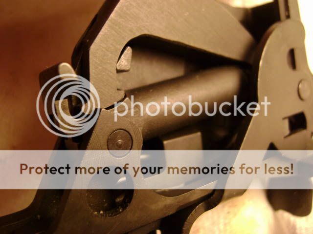

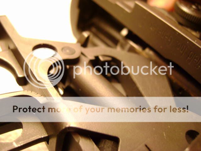

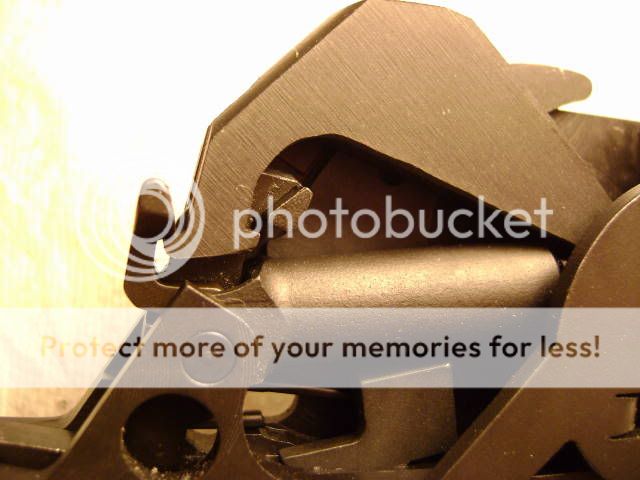

The following pic shows the issue Jon brought to their attention of the hammer travel during primary cocking.
Problem solved within 24 hours by 762MM. The bolt is larger in the rear and primary is the term I will use for the beginning
of the cocking process. This is the where the hammer should be, in relation to the housing, while primary contact of the bolt is
happening.
The next pic shows the same thing from the perspective of the trigger to hammer relationship, at the same time. Once again,
this is now corrected.

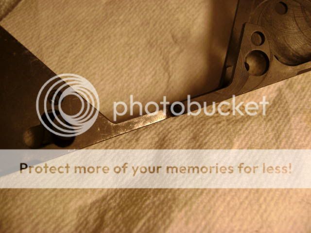

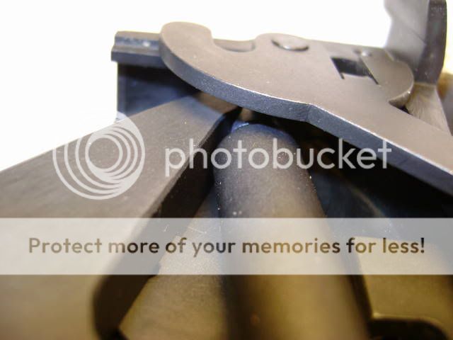

Here is another of the issues Jon found in his review, the contacting of the hammer spring housing, with the hammer, when in the
same position as above pics, primary cocking. Again problem solved, I was able to get a .004 feeler guage between the two, in this
position.

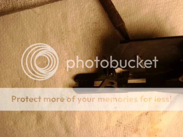

Another issue, the burrs at the safety spring fitment location, now solved.

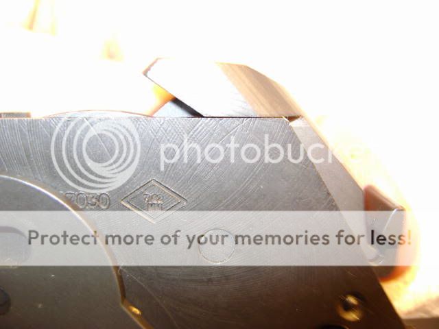

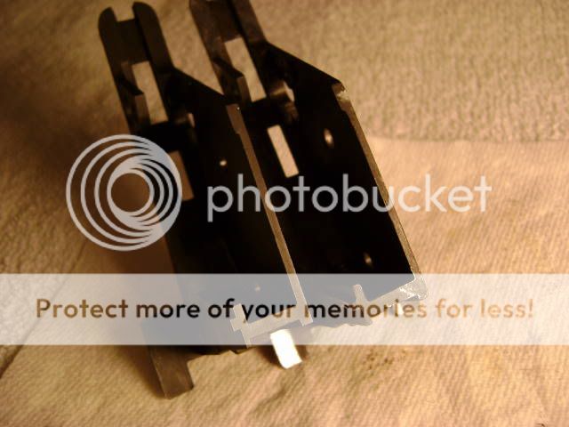

Here is the reason the safety rode to the opposite side of the relief hole, than other G.I.'s that he compared with
The inside radius turn at the 90 degrees, as it clears the housing bottom inside, note the thinner G.I. safety. This has no adverse
affect on function, and is on the thicker side of my prints as allowed by the military.

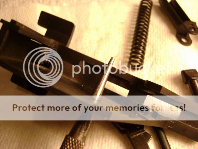

Another point of interest is the nailset punch I used to stand them with. Notice the 762MM has slipped up on the knurled
surface of the punch, and the HC G.I. will not, indicating the hole is larger in the762MM. Also no affect on function,
as the rest of the entire safety I examined was on the large side of the blueprint, having more metal surrounding the lock hole,
and overall thicker.

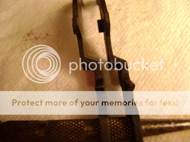

TRW comparison pics, you be the judge. Notice the wide moon shape transition from the flat behind the mag catch on both,
several other examples I checked, including SA,WIN,and HR, had much less of this cut done as wide. This shows great attention to detail by 762MM.
Beefy at the top.

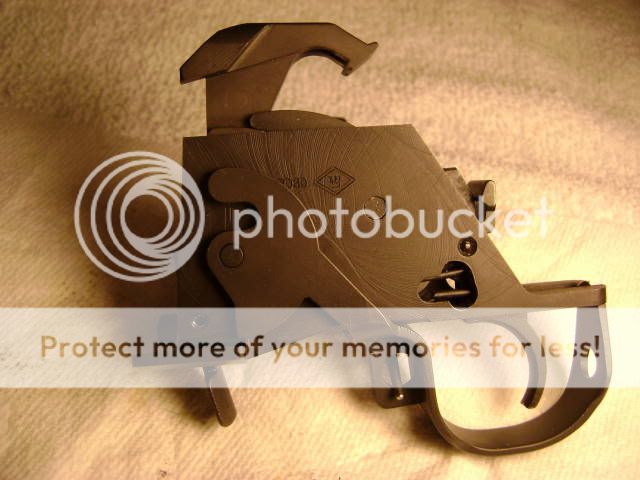

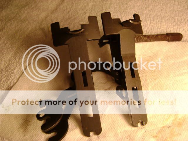

Trigger comparisons

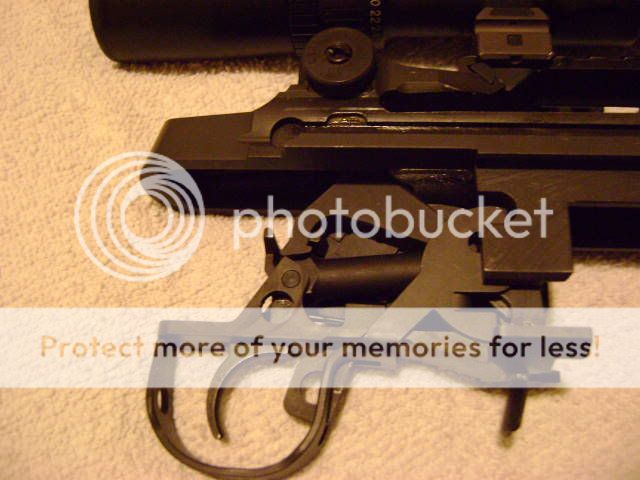

Installed in SAI June 2009 model

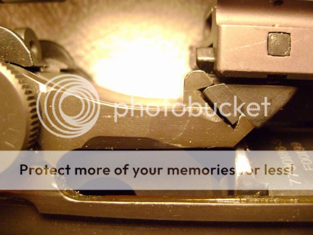

Installed, primary cocking, Note: proper hammer hook location and bolt position.
Installed, full cocking.Note: bolt position and relieved hook position due to thinner
bolt body middle, again, now corrected.
Installed, Fired hammer position.
A few more comparison shots.

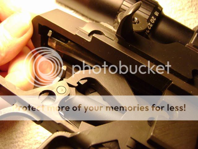

Now, here are some interesting shots that everyone should check on their rifles.
This is after the rifle is fired, and the trigger is still held back.Note: the primary engagement
of the sear to the hammers rear hooks. Correct and much needed safety check for all.
Actually in this sense of the proper terminology, the sear is working as the disconnect.
But I am not about to get into a fight with Uncle Sam....Gus Grin...The top of the trigger on the
M14 is the actual sear.

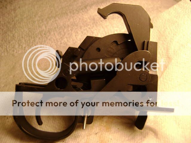

Here is the trigger being released to just about the point of firing.
Note : The proper secondary engagement relationship, of the front hammer hooks
and the trigger, about to take over.

polished the inside of the pass thru window sides and reblued.The safety spring housing teet that keeps the safety spring from creeping away from the inside wall was missing, and appears to have been a slight oversight during manufacturing. Once they corrected the previous burr problems at this location,
I suspect the machine was neglected from being reprogrammed to leave the stopper teet in for the safety spring.
I have made Chris aware of this and it is being fixed I'm sure. The spring cannot go anywhere once the safety is installed anyway, so I believe it was incorporated in the design for assembly purposes only,...just my opinion.

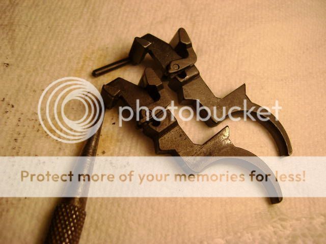

Trigger comparisons: As seen above in the photographs, a novice would be hard pressed to find the differences, I couldn't.
The only thing I did find was the pin that holds the sear to trigger assembly looks different on the ends, thats it.The G.I. has a slight concave
on both ends, and the 762MM is smooth. The play from side to side of the sear, and fore and aft movement, was the same in all checked.
Springs and pins, hammer spring housing, and plunger all appeared the same as G.I. comparitors. Measurements confirmed this as well.
Now that I have addressed all of Jon's findings, here are some of my own findings.
First off, I would like to thank Hawk, because I asked for special permission to go pic heavy on this,
and we both felt that the success of a new manufacturer of G.I. quality parts, is paramount,
and important to the entire membership.

The trigger housing pads were a full .010 thicker than all G.I. I checked, and I really like the look and heft of it.
You may say, won't that affect lock-up ? No is the answer, I checked the measurements on all the others from the top of the
housing, to the inside bottom of the pads, all were 1.722 and so was 762MM's. The rear pad was a full .003 thicker, and once again,
on the bottom side so as not to change lock-up. At this point in the reviewing process I go through, I noticed the pin for the mag catch
had a slight hang to it, allowing it to rub the trigger guard. A quick tap with a center punch finished seating it flush,... no biggy.
Disassembly was a snap and had no problems reassembling several times. This is one quick way to find problems. Tear it apart, put it together, ..

Hammer comparisons yielded only a couple remarkable differences, but again, all within print specs and having no affect on functioning.
Overall height of the comparisons showed the 762MM to be .003 taller, once again top of the spec line, but the 60 degree concave facet on the top
of the hammer for bolt cocking, was relieved properly and appeared larger than the comparitors in area, as it should for working with larger material specs.
Hammer hooks and design: I found the hammer hooks to be exactly .0015 longer front and rear from the comparison items. The hooks all had the proper
radius turns for aiding in cocking against the top of the trigger and front of the sear. Bevels at these locations were the proper angles as well,
and the let off and creep travel were approximately the same as random others checked, with the exception of the newer feel, taken into consideration.

I checked the safety to housing wall fit, and the index pin bearing areas. The safety was relieved properly
around the terminal pin just like the G.I. ones. There was no drag on the housing wall like I have seen in several G.I. safeties.
I specifically looked here to make certain the extra top of the print thickness of the 762MM safety would not be an issue in this area.
The extra thick bottom where it passes thru the rectangular housing window, did cause a tiny scratching of the safety above the lock hole
during functioning. It then seemed to subside once the park was knocked off. A little cold blue, later confirmed this. I also went ahead and
